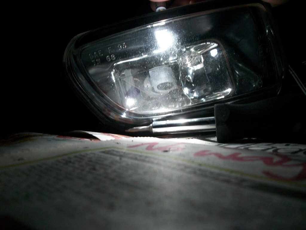

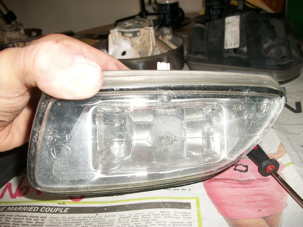

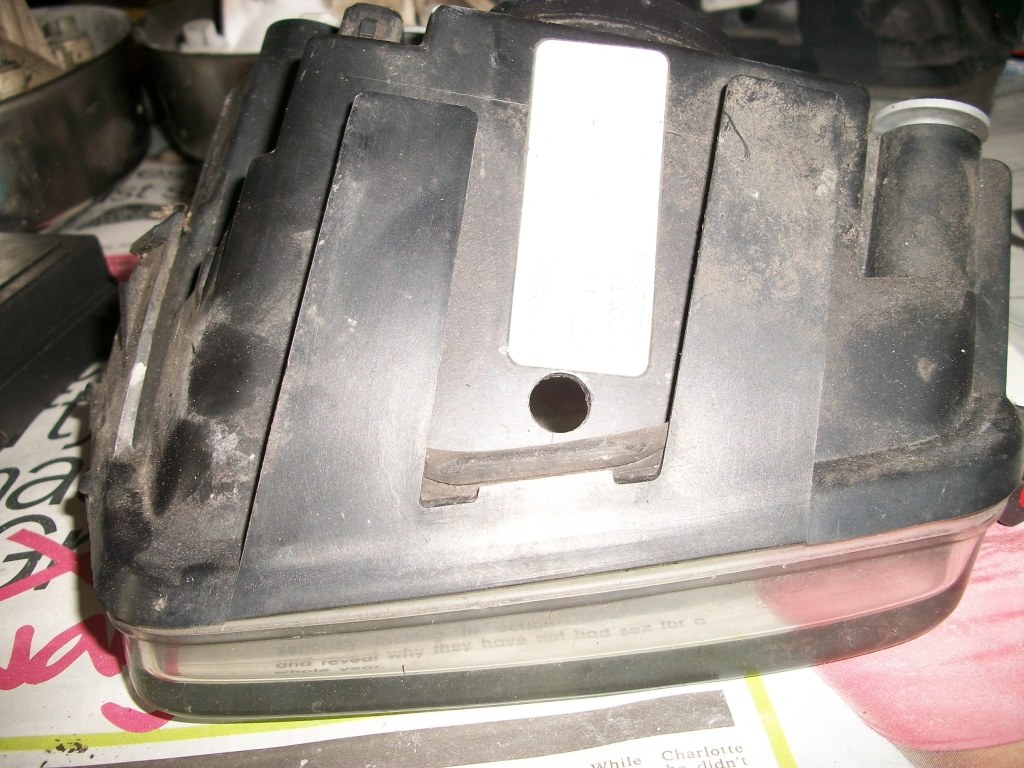

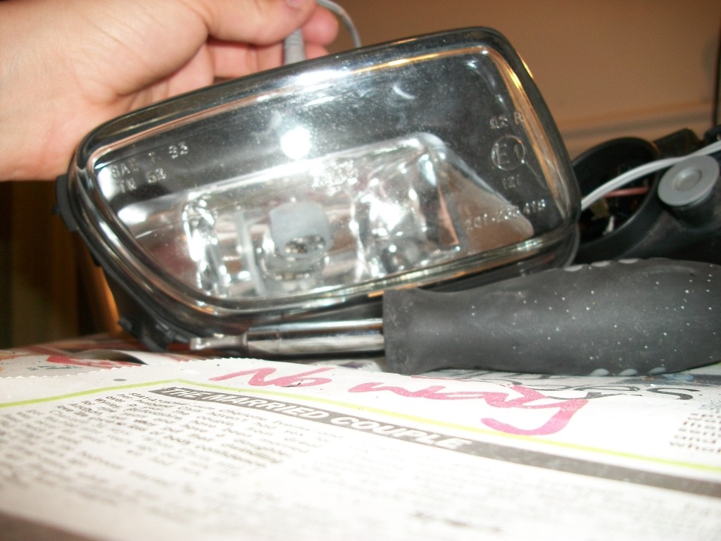

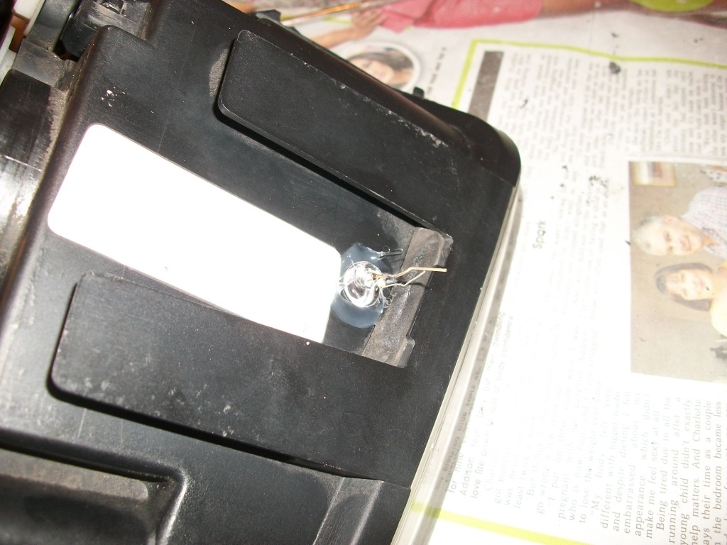

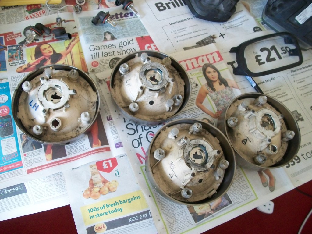

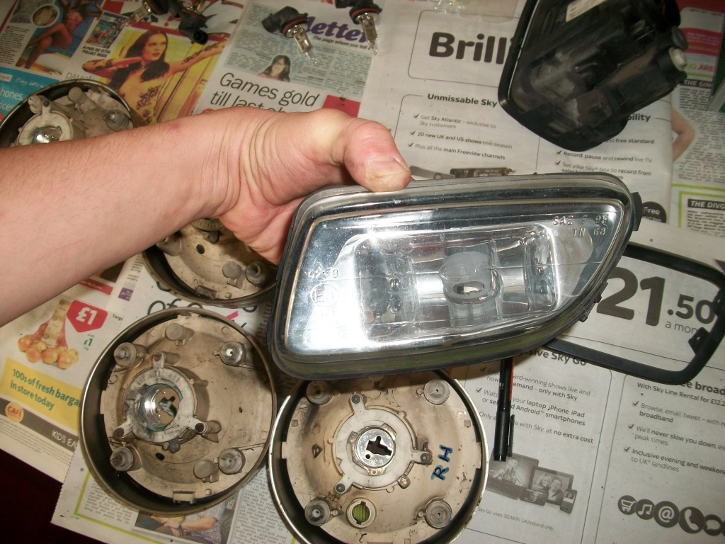

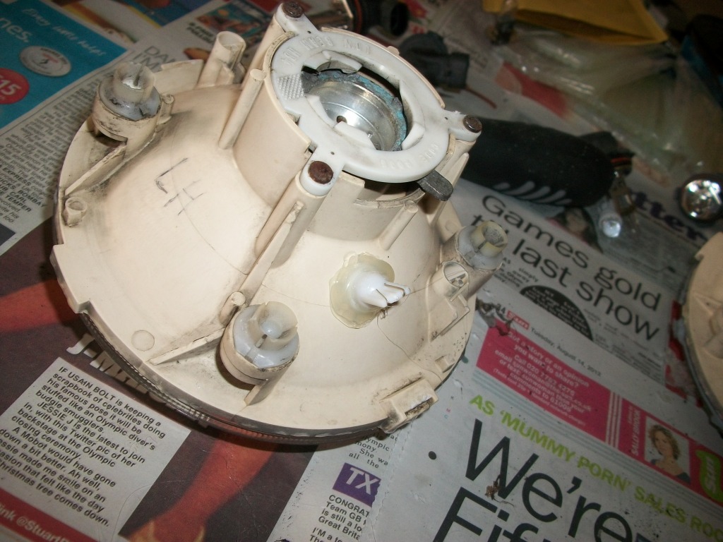

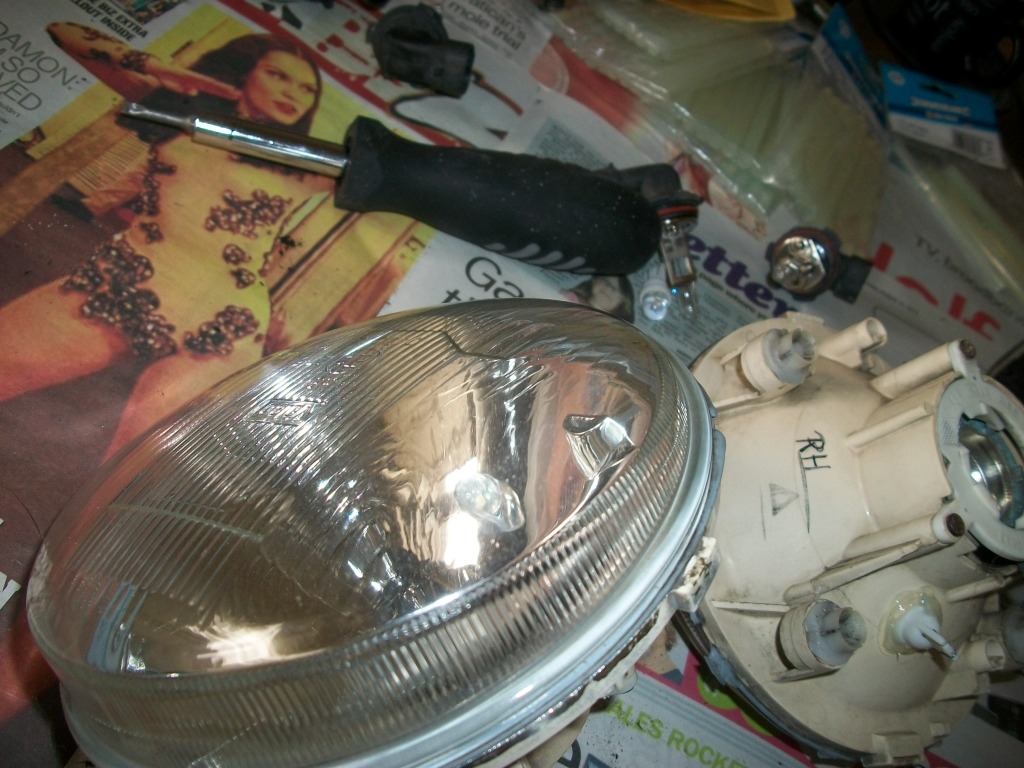

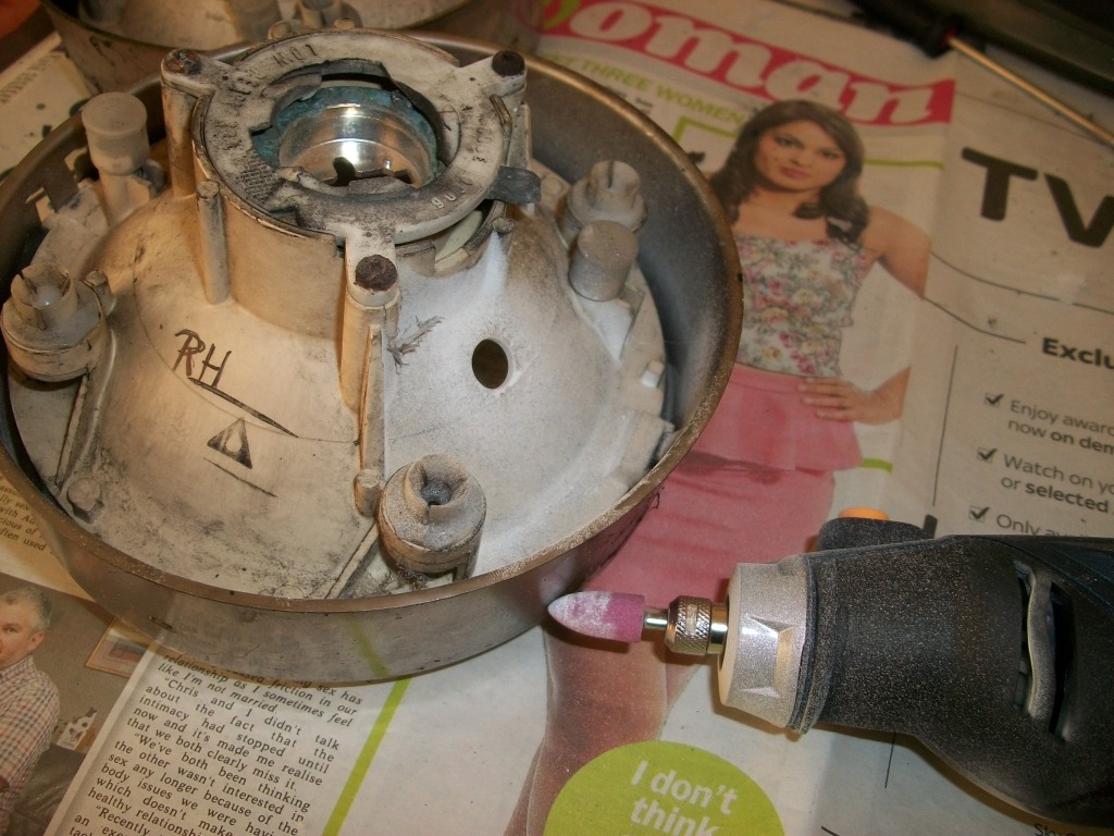

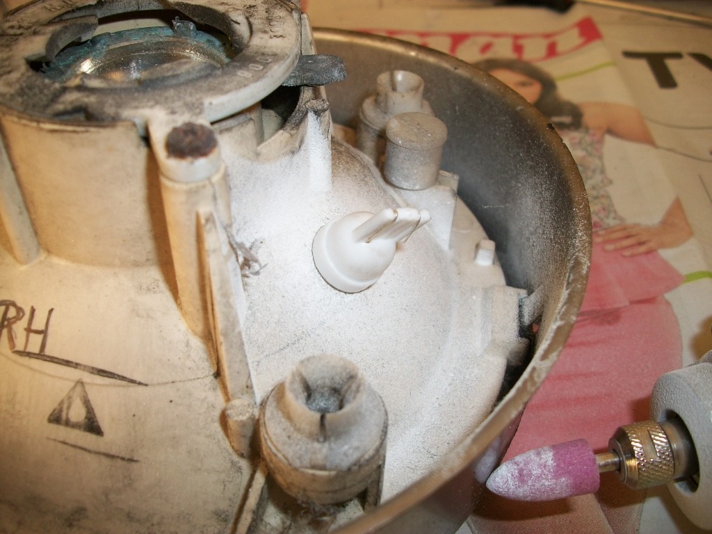

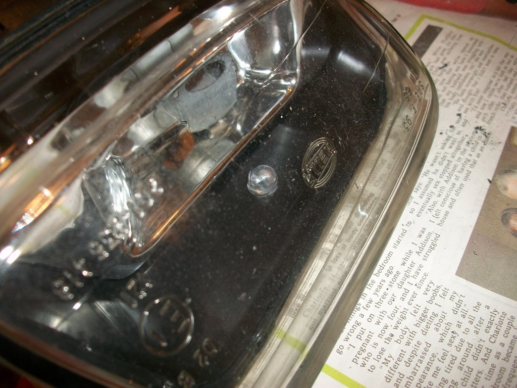

Ok, Tim, little treat for you! Everyone's going mad over LED lights, day running lights and all those posh looking Audi style lights, etc...
As I've seen in some other post, opinion about putting led strip on a Jag is rather negative, and I'm not surprised, because in most of DIY cases it would look rather poo... I did it myself on my father's Chrysler Grand Voyager, and I wasn't pleased with result at all.
But I still wanted all the lights in the front of my XJ6 to be illuminated, as sort of day running lights, with some LEDs. And since my wife asked me the same thing, (mutant or what, reading my thoughts!) after a short while I came up with rather risky (at least it might seem to start with) idea. Maybe I'll let the pictures do most of talking.
After pulling the lights out of the car, I decided I'm not going to clean them until most of preparation is finished. It should become clearer in few seconds
LEDs on pictures are for test fit purposes only, NOW I shall clean the lights inside, I didn't do it earlier as I knew drilling the lights would produce a bit of dust, which I'd have to get rid of, so double cleaning would be pointless. Full beam, or high beam if you prefer, lights were drilled to accomodate single big LED in roughly same location as the low beam lights. Plastic is hard enough not to start melting while drilled, there's just a bit of dust, which I found better than melting plastic of fog light cover. And hole in the fog lights is positioned in such a way, that LED itself will not be visible, unless someone decides to give the bumper a kiss.
Let me know what you guys think about this mod! When everything's finished, I'll post a video tutorial as well, if the mod will be approved by Jaguar Forums users

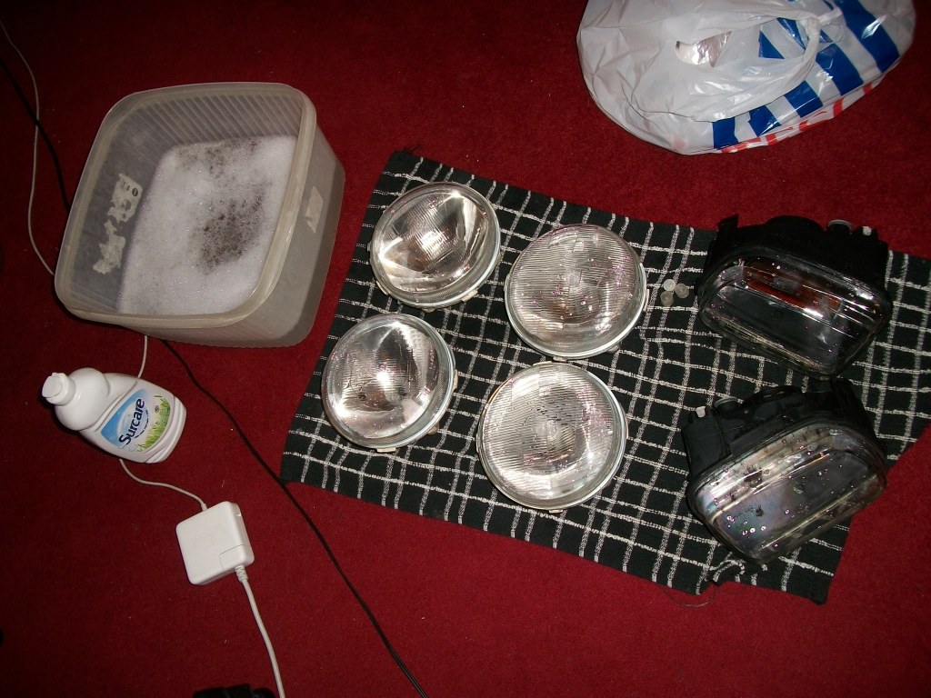

After wash (inspired by link Jaguar XJ6; Jaguar X300; Jaguar XJ6 3.2 Sport; Miscellaneous notes )
Now, a quick question, should I leave them to dry like this, or should I flip them, so they would be resting on lenses?

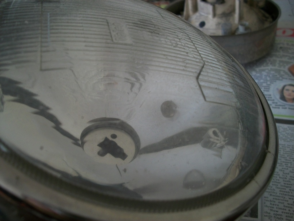

The holes I made are rather tight fit, but yes, sealing them up is another thing as well. And since they sit in the new 'socket' tightly I decided to go for hot glue.

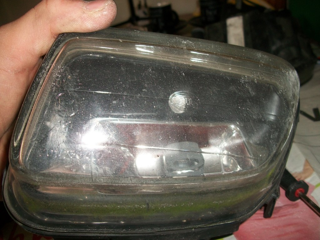

The units have been cleaned, all those 'particles' you can see on the glass seems to be just the standard damage on the outside.
I'm thinking about wiring them up to the standard sidelights (the front ones will be replaced with LED's as well) and adding extra switch for the LEDs in high beam and fogs, if it makes sense... Probably I'd have them on most of the time, but it would be possible to switch them off if necessary

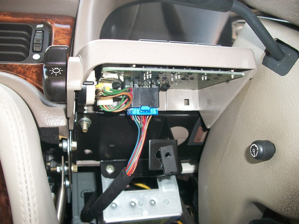

As I mentioned before, I wanted to run separate wire from sidelights to separate switch, which would enable me to switch on/off the additional LED lights... Now, here's the problem, I wanted to tap into one of the wires not far off the main light switch, but which one should I tap into? I tried to get the power from the main switch, as there are 4 wires and the solder is pretty much exposed, so it should make it easy, but then I run the tests with multimeter, I totally lost it, I can't figure out which cable should I connect to Or should I connect it somewhere else? My electronic knowledge is very, very basic
If anyone can help and you need a better picture or at a different angle, just let me know, and I'll upload as soon as I can!

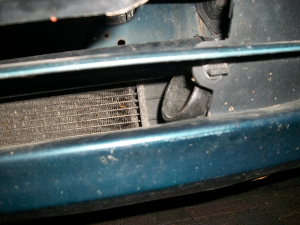

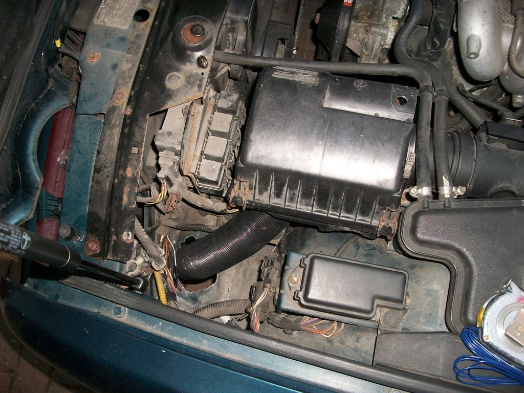

But at least the airbox is there again, with direct cold air intake from behind the bumper

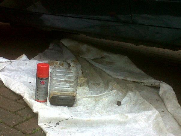

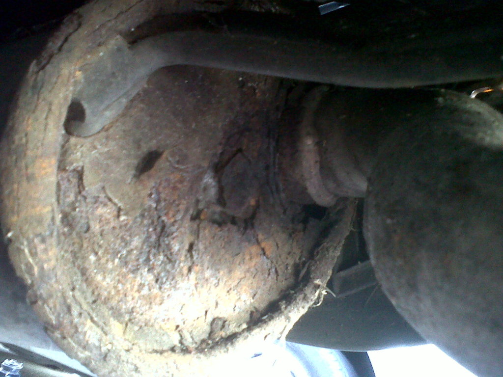

Today I managed to change the oil in gearbox... According to every source possible, it should be 1.4l of oil in it... A lot less than automatic But what I drained out of it wasn't even 0.5l!!! Name:  486864_147255815420848_1539054887_n.jpg
Outrageous!!! That might explain why gearbox felt a bit stiff... And hopefully that might help as well with a bit of a noise I was getting in neutral... We shall see... I changed the oil in differential as well, thanks to the guide in Quick How To Links... It smelt nasty! And stuff that collected at the bottom, on the drain plug was like nasty version of Play-Doh!

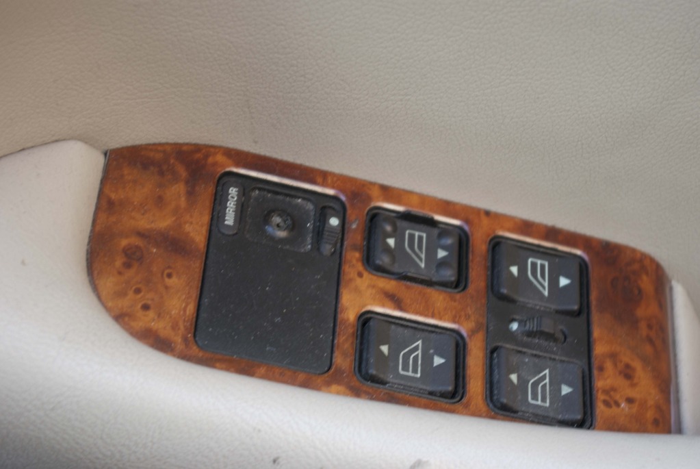

Any help and suggestions appreciated here: I replaced the mirror switch which was broken in rather nasty way, Name:  _IGP9373.jpg
Got replacement for 12 quid with postage, although I still can't get the mirrors to work... I run out of daylight at the time to carry on pursuit, but where are the fuses that I should check for it? Cheers guys!

My temporary fix was a small screw threaded very gently into what was left behind by the missing joystick. I'll post a pic later. I actually opened up the box to Pre-drill the hole, install the screw and drop in a little hot glue to hold the screw firmly. Looks ghetto, but is temporary.
Old Oct 7, 2012 | 09:12 AM
  #32
FireCrow's Avatar
Joined: Aug 2012
Posts: 477
Likes: 72
From: Ipswich, UK
well, I have whole new panel, with proper joystick there installed already, and it was a bargain at 12 quid, as most of them were going for well over 40 quid... I just hope it's the fuse, nothing else...

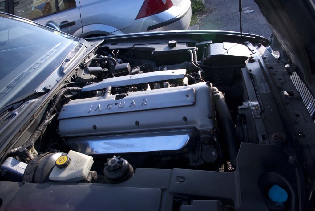

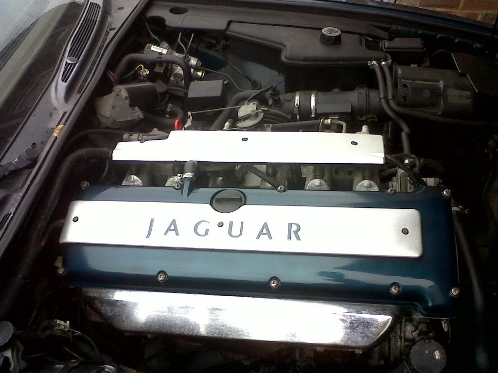

Did I mention I painted the engine? Yeah, I gave it a bit of respray, so here you have the old look:
and the new look:
Paint job is not perfect, but for a quick job on the driveway looks ok, I hope!
I haven't finished the lights mod, as the rain stopped me... Never mind, lets hope for dry Sunday...
