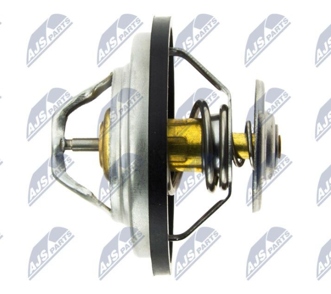

Ill order a new thermostat right now then.

2 options came up with the thermostat, might they both be interchangable? Also, both seem to have gaskets coming with them. Part number seems to be AJ86484

If you change the thermostat keep in mind that it does not take a large O - ring even if it comes with one , bad , cracks the thermostat housing as you clamp down

PSA - be careful with oversidzed orings when changing thermostat
i was just changing the thermostat and decided to use the oring that came with the thermostat, and while tightening the bottom screw where there is poor visibility, i didnt notice how the cover is bending at the bolt fitting place, and the it broke right off. Did not even have any resistance, it just broke off. Postponing most tests to when a new cover arrives in mail, as i dare not to run the engine right now
could be that i just positioned it poorly in a hurry, or it was under a lot of pressure before as the previous owner didnt use any gaskets at all, just sealant, but then again the metal used here seems to be some brittle alloy
