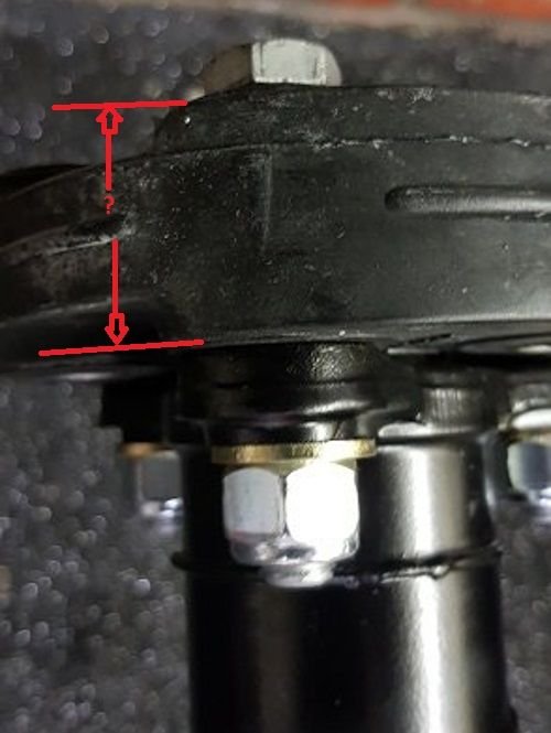

I am building a driveshaft for my 1966 S Type that has had a transmission swap and I need to use a CV joint at each end because I cannot get optimum angles to use u joints. The angle works well to use an X300 Jurid at the diff end ( and I have the flange adapter to fit the S Type diff). However, to find the driveshaft length I need to know how thick the rubber coupling is.
Could anyone take a measurement of the rubber thickness from the diff flange ears to the driveshaft ears please?

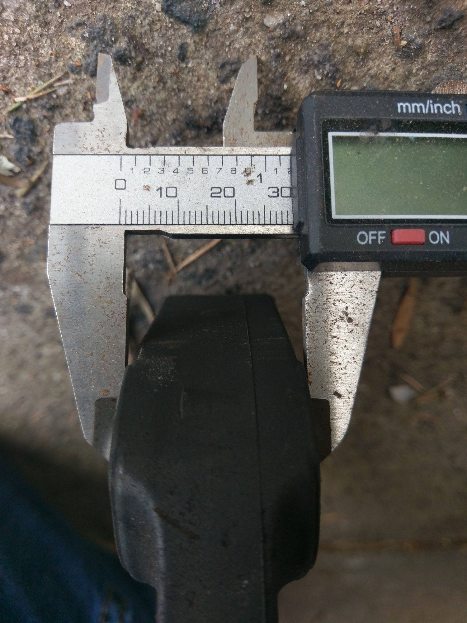

I actually replaced my Jurid coupling a couple of months ago with the advice of a few helpful people on this forum. So as it happens I still have the old one on hand and can offer that measured at the Metal Bush it is exactly 30mm I hope this is the measurement you were after

Thanks very much, that was exactly the dimension I was looking for.
