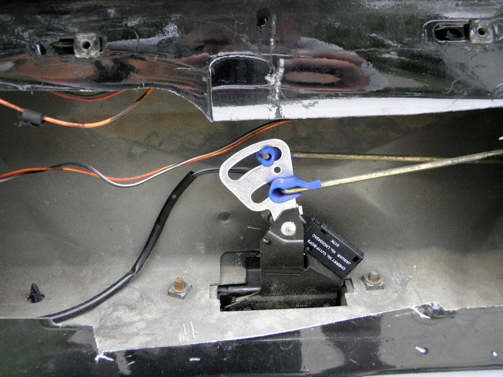

I'd say that loose wire goes to the micro switch on the latch. If it's not connected, it's telling the computer that the boot is open, so none of your buttons or key fob try to open something that is already open.

Near the solenoid - it looks as if a spur has been let into the wiring! There are two wires one is yellow with an orange tracer, the other is black. Joined into this is one blue wire and a red wire which go to the solenoid. I have now ordered a new latch assembly from a breakers with the attached micro-switch. It is in the post so I should get it early next week.

The brown connector with the yellow/orange and black wires is the one that connects to the trunk release actuator solenoid. Are you saying this connector is loose and someone has tapped into these wires that then connected those to the solenoid?
If that's the case, I'd say someone has replaced the solenoid that may not be original. Or maybe the original connector is buggered and they rigged it up to work. Kind of hard to say without looking at it.
I'm not finding the microswitch on the electrical diagrams.

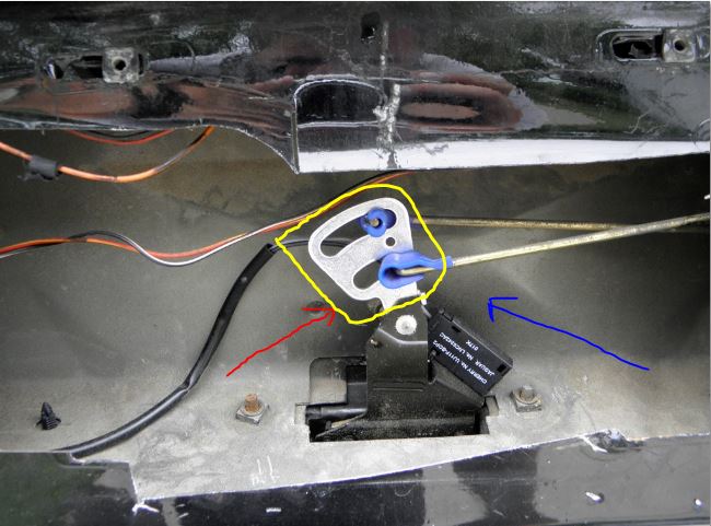

I can get (through the license plate holes) to the part where the rods are attached with a long screw driver. Which way does the mechanism work [i.e. Do I push it to the left or right ...(To clarify my question, I have added red and blue arrows to your photo and attached ..)]?
I have found the answer here : https://www.jaguarforums.com/forum/x...oot-faq-57621/
