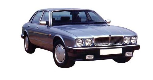

Welcome to the forum heuster,

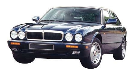

Do you have:
XJ40 (which could have single square headlamps)
OR
X300
Both of them are badged as XJ6.
