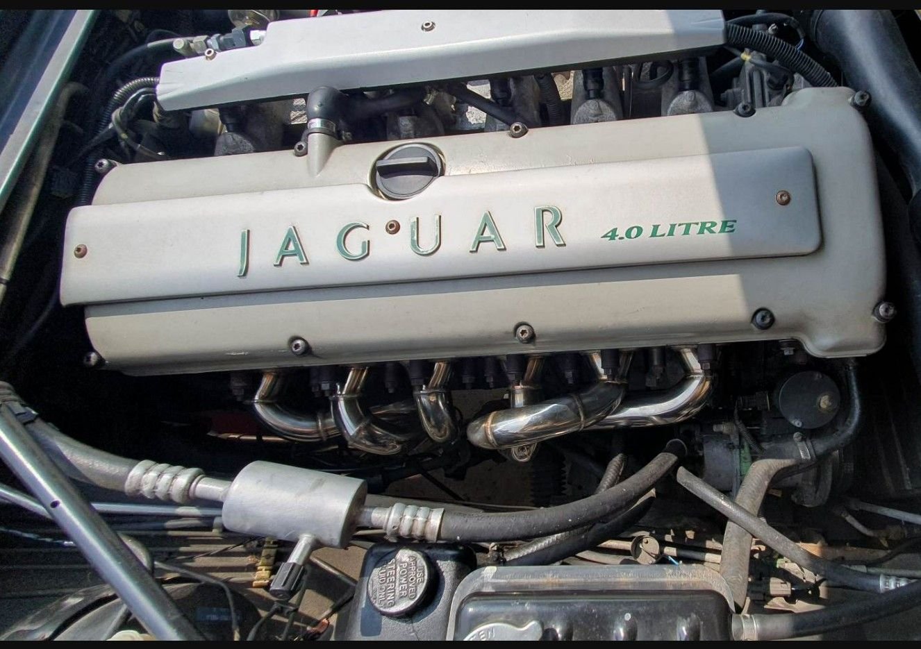

There is a guy on facebook who made a batch and sells short tube/medium headers. They are a 6-2-1 I think.
I'm pretty sure the guy is in this group > https://www.facebook.com/groups/XJR6supercharged but I can't find a pic from him. He may be on this site too.
