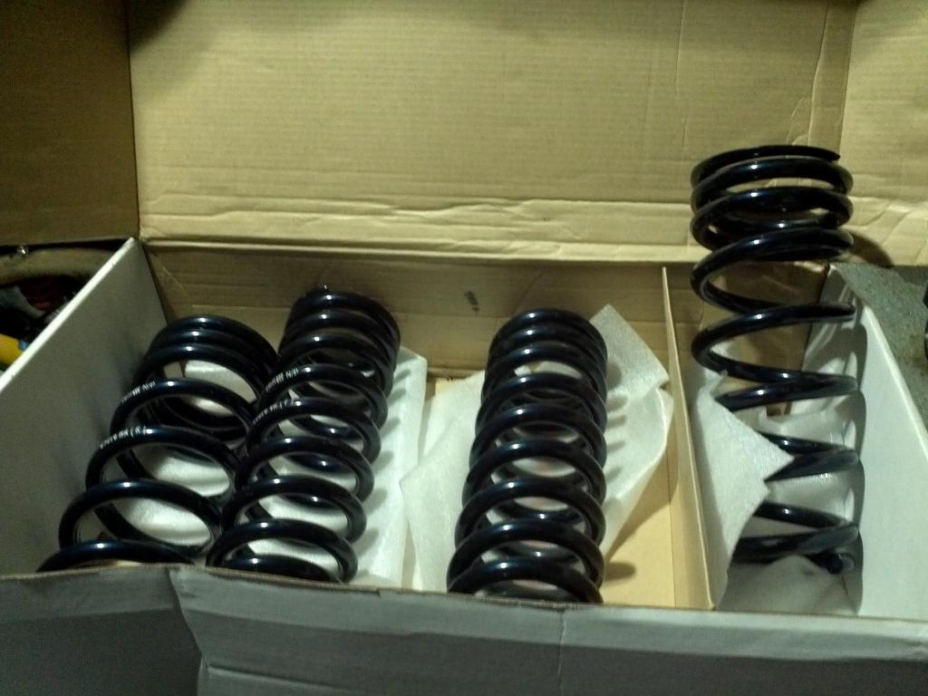

Old Nov 26, 2014 | 11:44 PM
Compounder's Avatar
Joined: Jul 2014
Posts: 56
Likes: 8
From: Georgia

Be sure to get some before & after exterior photos of the car, and measure the actual before/after drop so those thinking about doing this can reference this thread to see how it works out.
Replacing the springs on the X300 isn't rocket science, but it is a bit of a chore compared to other cars.
Check out the "How To" for replacing the rear shock thread as that covers removing the rear springs. Since it is such a big job, I'd recommend also replacing the rear spring/shock bushings and possibly the shock itself while you are in there.
Here's that thread:
https://www.jaguarforums.com/forum/x...ent-how-62143/
There are some threads on replacing the front springs, and a post here or on Jag Lovers on how one can make the special tool required as normal spring compressors apparently can't be used since the front XJ springs are installed in an "arc" instead of straight. The factory spring tool is available too, but very expensive.
However, again, trying to use normal spring compressors on the front is apparently very dangerous.
Jaguar SPRING COMPRESSOR TOOL, FRONT SUSPENSION - JD115-OE
https://www.jaguarforums.com/forum/x...pressor-82083/
Jaguar XJ40 project: Front spring compressor tool
http://www.xj40.com/viewtopic.php?f=24&t=3733
There's also a thread here somewhere where someone made a very robust homemade version of the tool for the front springs. I tried to find it quickly, but didn't. Maybe you can with a bit of searching.

Finally finished up my suspension. The car really handles great now. No more clunks and leaning at every turn. Here is a quick review.
Shocks- Bilstein HD Typical excellent Bilstein feel, not to stiff or soft. They seem like the harder you press them the better they are. Very smooth over rough pavement but when turning aggressively they are firm.
Springs- H&R These are 45mm shorter than the factory springs but just as I expected my car sits about the same as it was since it was sagging horribly. The springs are definitely more firm and give the car a more solid feel. Between them and the shocks my car now turns flatter (no dipping) and seems to react much faster to steering input.
Bushings- Powerflex and superflex I used both to try and get all of my bushings changed to poly and spent over $800. I'm really happy I did because they were a pain in the a$$ to change and hopefully that will be the last time I have to mess with them. I have a lot of experience in poly bushings and have went to them on several vehicles and they are all about the same. I can feel more of the road, transmission shifts and engine revs. I really like that and it reminds me of a BMW feel.
In short I really recommend all 3 of these upgrades not to mention the Andy's sway bar drop links which I also believe helped with the flatter feel and steering response. I don't think the car rides harsh at all. I am very satisfied with the ride and feel of my car now.
