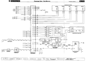

The section on seats is 14 . I would assume the loom is installed and may be coiled up inside the center console of there is room
http://www.jagrepair.com/images/Auto.../jagxj1996.pdf

I realize, that all the landscape pages has been cropped, so it's impossible to dechifer the codes in the left side. Does anyone have the landscape sketch no. 14.9 in an intact version?
This is a print from the 1996 ( the 1995 version is hard to work with ) wiring guide , there may be some differences .
The whole 1996 Doc. can be found here :
http://www.jaguarclub.sk/service/x30...al%20guide.pdf
