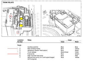

For a cheap and easy try , try swapping the fuel pump relay with the rear window defrost relay as it might be intermittent .

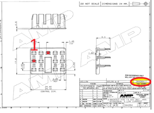

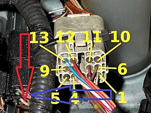

For a chance that it's a weak spark different then control or timing check the condition of the White / Pink wire in the Papa Indy 1 connector position 4 . All 6 plugs get their power though this one wire as it goes through this often corroded connector located below the washer fluid fill cap .
