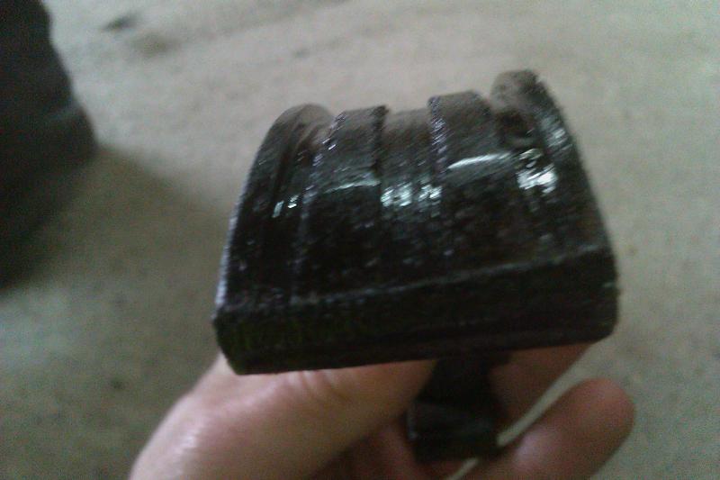

Hi all,
I give you some news.
I found the problem was my secondary tensioner.
I redid the whole of timing chains, tensioners and dampers. It was a good idea. In addition to my mechanic is nice I was able to attend.
Then the oil pump chain was relaxed, the tension is not simple and psiton was worn but nothing serious my sound did not come from there: tensioner changed. The primary chain, guides and tensioner was worn but in good condition: normal and refurbished. When the secondary channel noise was coming from there (see photo). Although I Avias the new model of tensioner, it was not completely committed to where the noise, heat the oil pressure maintenanit stretched so no noise, cold thick oil pressure therefore not immediate noise and hot engine oil that cools down the oil pressure and play at the piston of the damper: so the video noise.
All new and reinstalled the sound although it is new parts ..... In fact the procedure Jaguar says to put further retracted, disconnect the fuel pump and kick starter to lock (which tapped damper and clicks) except that it does not switch completely .
So if you have the same noise or redone the timing chains with the new model of tensioner, remove the camshaft cover and snap the piston manually to be sure it is sufficiently activated, I was two steps before the final and now I'm on the penultimate and no more noise .....
