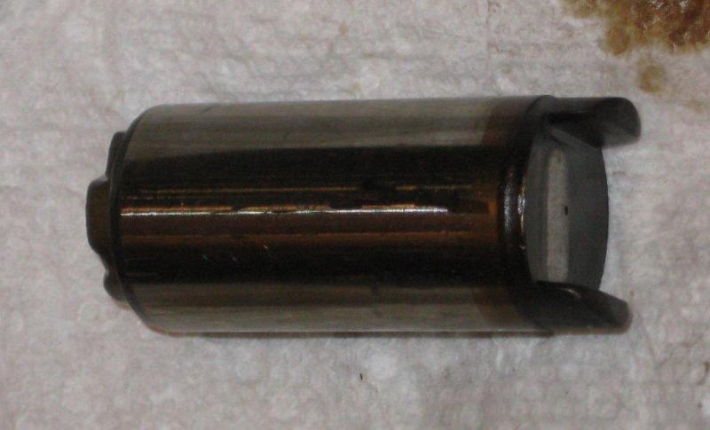

The piston (see attached pictures or pictures in my photo album) shows a variety of wear scars.
a) short deep scars and pitting near the 'inside' edge of the piston - possibly due to being deflected by being 'pushed' down by the angled timing chain guide
b) long scars - possibly due to the internal ratcheting mechanism failing (piston retracts completely when oil pressure bleeds down)
c) a deep and wide scar/gouge in the piston face - likely from the timing chain guide being not being orthogonal to the piston face, but instead at a oblique angle
So, without an in-depth failure analysis I have the following hypothesis.
Two separate failure modes.
1. The piston ratcheting mechanism potentially failed, causing the long wear scars (piston extending/retracting completely on repeated startups). This extension/retraction may also have contributed to the gouging of the piston face by the timing chain guide.
2. The timing chain guide deflecting the piston, causing the short scars and pitting at the inside edge of the piston.
I noticed that the fit between cylinder and piston is not extremely tight on both the old and new tensioner assemblies. This contributes to the piston cocking in the cylinder bore. The reason for the not so tight fit may be either not the highest quality manufacturing, or it may be intentional to handle thermal expansion difference between the piston and the cylinder bore (different materials).
Attached Thumbnails Note:  The redesigned upper tensioner on the X300 can also fail-img_8509.jpg   Note:  The redesigned upper tensioner on the X300 can also fail-img_8517.jpg   Note:  The redesigned upper tensioner on the X300 can also fail-img_8519.jpg   Note:  The redesigned upper tensioner on the X300 can also fail-img_8520.jpg   Note:  The redesigned upper tensioner on the X300 can also fail-img_8522.jpg
Note:  The redesigned upper tensioner on the X300 can also fail-img_8523.jpg   Note:  The redesigned upper tensioner on the X300 can also fail-img_8524.jpg   Note:  The redesigned upper tensioner on the X300 can also fail-img_8525.jpg   Note:  The redesigned upper tensioner on the X300 can also fail-img_8526.jpg   Note:  The redesigned upper tensioner on the X300 can also fail-img_8527.jpg
