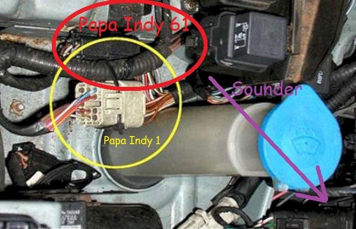

To clean up the O2 sensor signals clean the O2 sensor connector if green corrosion , the 2 small ground post on the rear engine fire wall below the larger B + post above with the battery cables , the dedicated external ground strap on the ECU case , and the large ground strap on the starter to car frame ground
There are the Papa Indy 1 and 61 connectors subject to a TSB on corrosion but lately haven't heard of anyone having that
Effects heaters so the sensors will read correctly . Papa Indy 61 position 12 White / Greem color wire , P1187 is all sensors heaters
