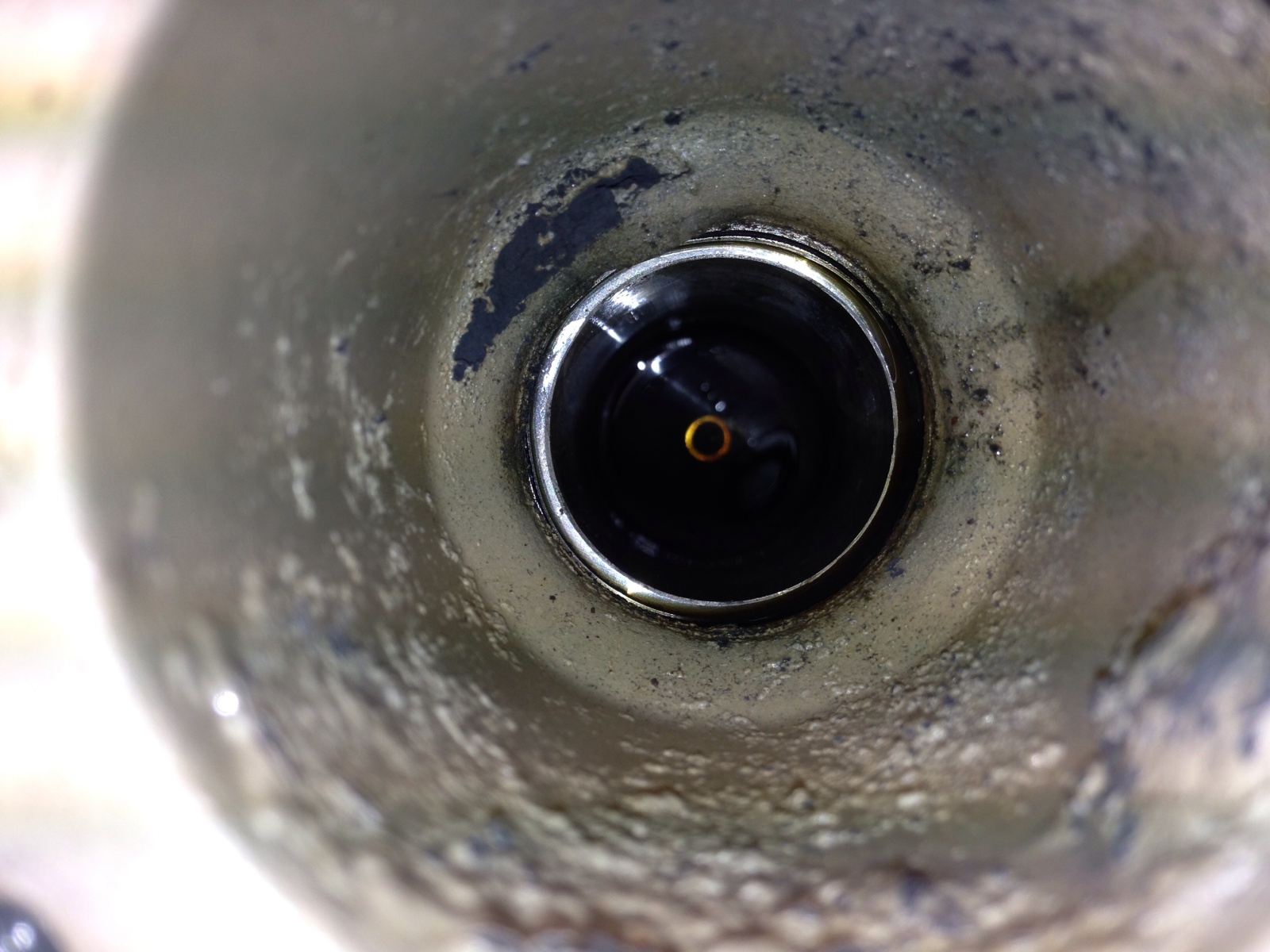

I found my problem, thanks everyone. The gasket flooded my spark plug and coil plug:

It would seem a miracle that it ever generated any power at all in those circumstances. I hadn't realised just how dramatic that oil issue can be!

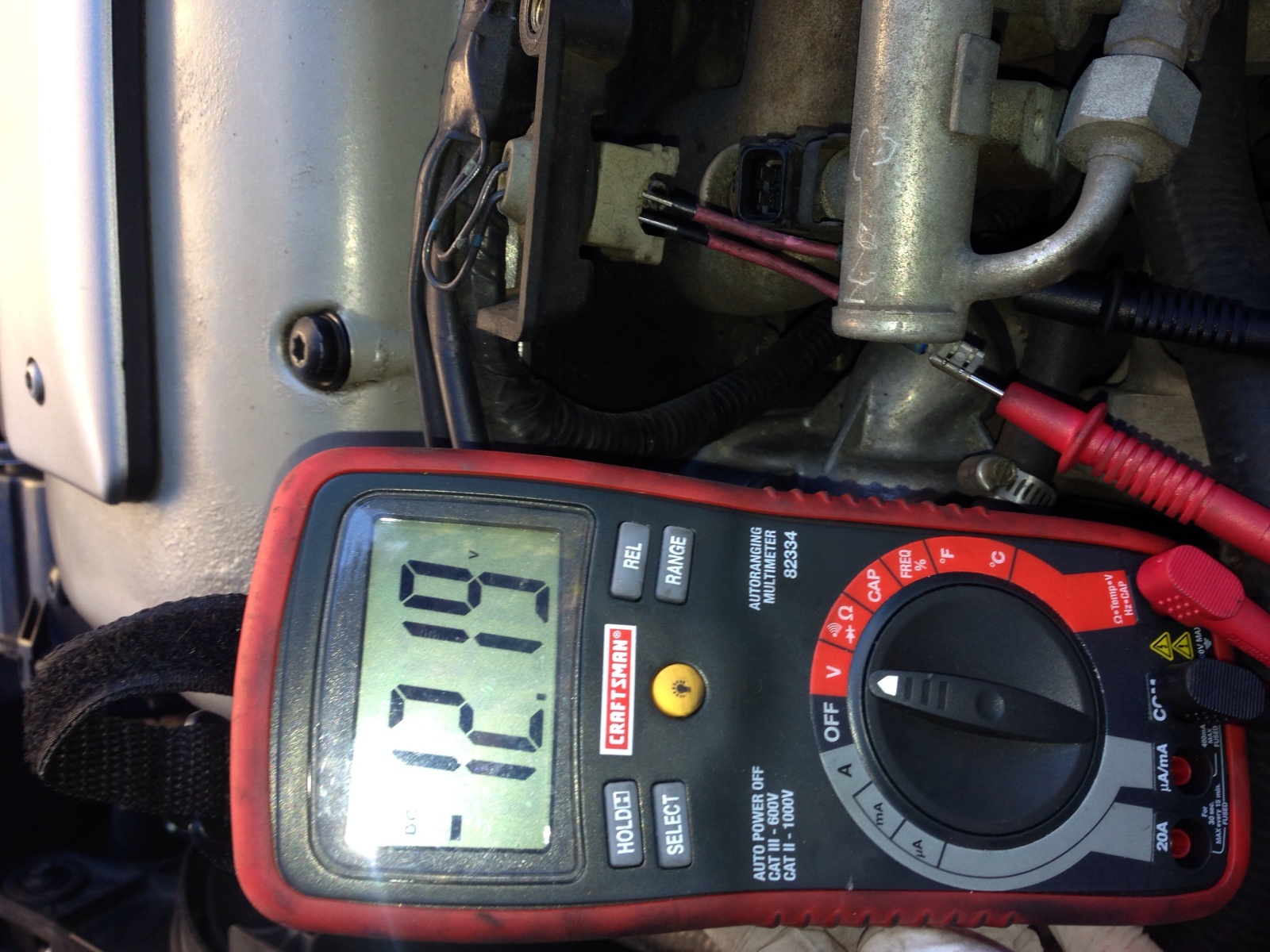

I was also getting a cylinder #6 injector code every now and then, but I took the cover off and found the power wire crimped. I tested cylinder #1 with a dvom and got 12 volts and cylinder #6 was getting about 6-7 volts. I repaired that also, but hopefully this can help someone out in the future if they have a similar issue.
