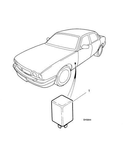

Apparently it's behind the kick panel at the base of the left hand A pillar.
I've had a look and there is a type of relay there but it has no markings on it to tell me what it is.
Old Oct 23, 2013 | 04:22 AM
Posts: 28,831
Likes: 11,290
Here ya go.
My parts lists has this as the "power steer module". Part # is LNA2100BB.
Might be a s simple as a bad earth, remember its a Jag, and you are in the UK.
