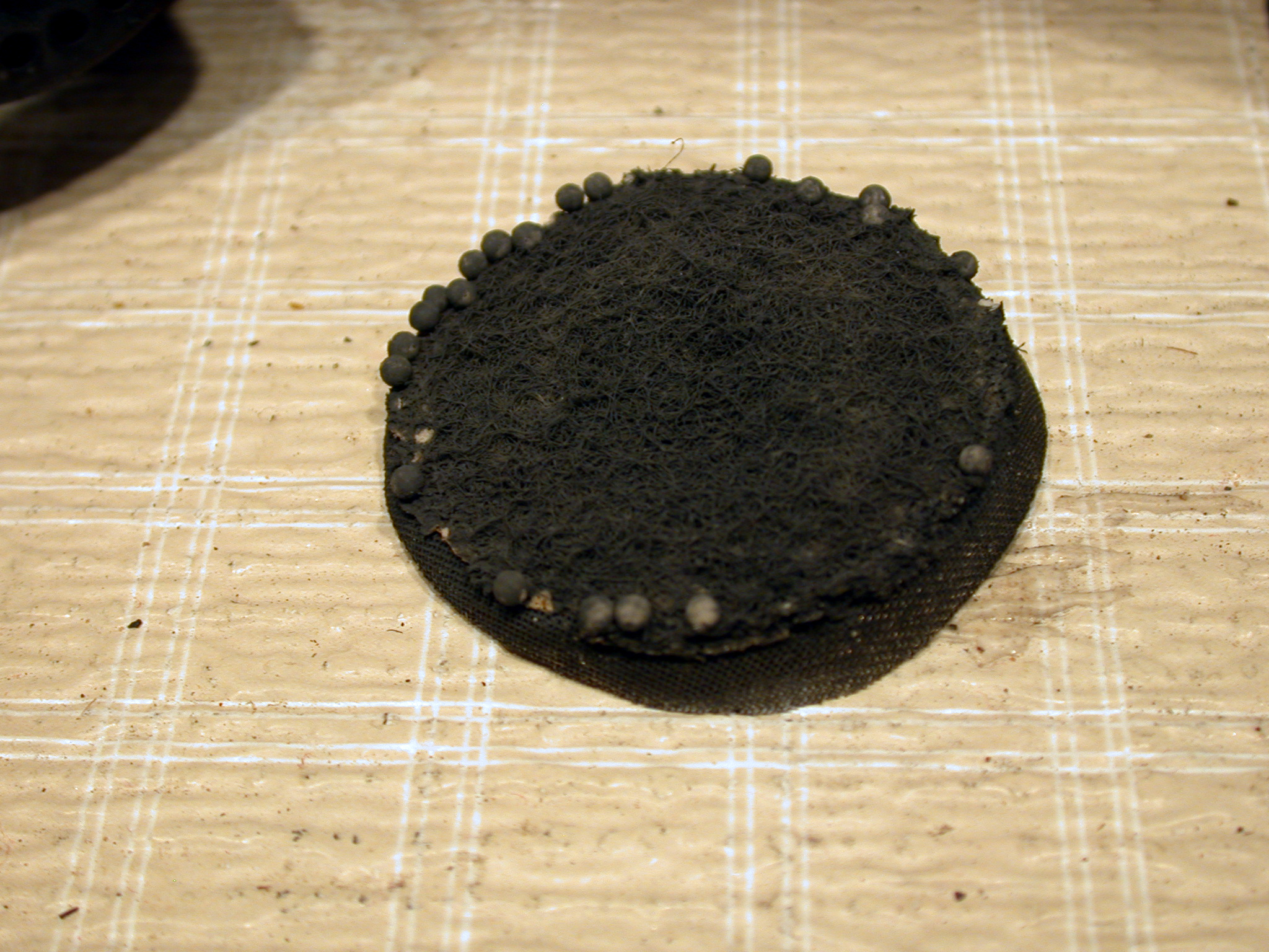

Have run into one thing that is very concerning. First off my tech and I replaced the compressor and dryer canister in the 95 X300 yesterday. What we found was the same thing I found eight years ago when the AC went belly up and would barely cool. The entire system was full of the pellets from the dryer canister. At that time only the dryer needed replacement. Since then it has worked pretty well. Yesterday we again blew out the entire system and hopefully got rid of all the pellets. The results were very good. AC for now is working great.
This morning I took the old dryer and sawed off the ends. And what I found bothers me. There is nothing inside except for one end that has a screen about 3 1/2 inches from the end and the other end just has an open tube sticking into the cavity. The thirteen inches I cut out of the middle has nothing in it. I assume this is where the pellets were kept but there were none there when I cut it open. This means the canister has to be oriented in a certain way. On the old canister the only notation was the word "top" on the end with the tube. But this makes no sense since the dryer is mounted horizontal above the condenser. On the new one there is no notation at all. Which means it could be in backwards with pellets again going through the entire syatem.

After looking on youtube and seeing other canisters, of a different design, that were fully opened up I decided to cut open the very end where the screen was (first picture). And I removed the screen and grate (second picture) and there were the pellets. I don't see how the pellets on this canister could have gotten loose in the system. They were contained in about a three inch section of the canister with intact grates and screens atboth ends. I have come to the conclusion that the pellets we found , and there were a lot of them, this time were left over from the problem eight years ago. Amazing the AC worked as well as it did all that time.
The last picture is of the pellet side of the screen. It is almost totally clogged. From now on I will replace that canister every time I have the system fully serviced. And I fully recommend that everyone do the same.

After opening up the canister I can't figure out how the pellets can get loose. The only thing that I can figure out is that the canister is installed backwards. But there is no indication on the canister. I think the input side of the canister should be the opposite end from where the pellet pack is located. That way the pellet pack is always being pushed up against the end fitting and is more secure that way. The opposite way may allow the pellet pack to be forced down the tube by plugged screens where it gets cocked and the pellets get loose. Be careful how you mount the canister.
