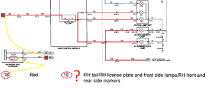

Are we referencing the Right Engine Fuse Box position # 18 as it shows a 10 amp fuse

If I understand the illustration right it looks like #18 is a 5amp and #17 above it is a 30amp. I don't know where the #10 comes from. I used to wonder if there was a running change on this fuse from a 5 to a 10amp, I have an early 96.

The 10 amp reference comes from the Technical Guide page 21 other then the Wiring Schematic that as they probably added more on to the circuit they put more horsepower into the fuse
There was a switchover from a 2 lamp control modual in early X300's to a single
Yes on the hinge damage as I have read alot of occurrences
