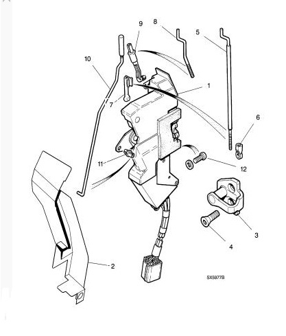

The door latch is an electro-mechanical device.

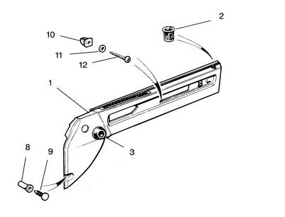

Two problems regularly reported are:
1. the lock button 'binds' in the lock button surround (see item 3) of the door top roll preventing the linkage from rising to open the door.
2. failed micrswitches in the door latch either don't operate or don't move the operating links fully.
The problem in opening the door by sliding a 'slim jim' down between the door glass and the door rubber to lift the release link is there a shield (see item 2) around the front of the latch to prevent this:
It is supposedly possible to work round this ......
