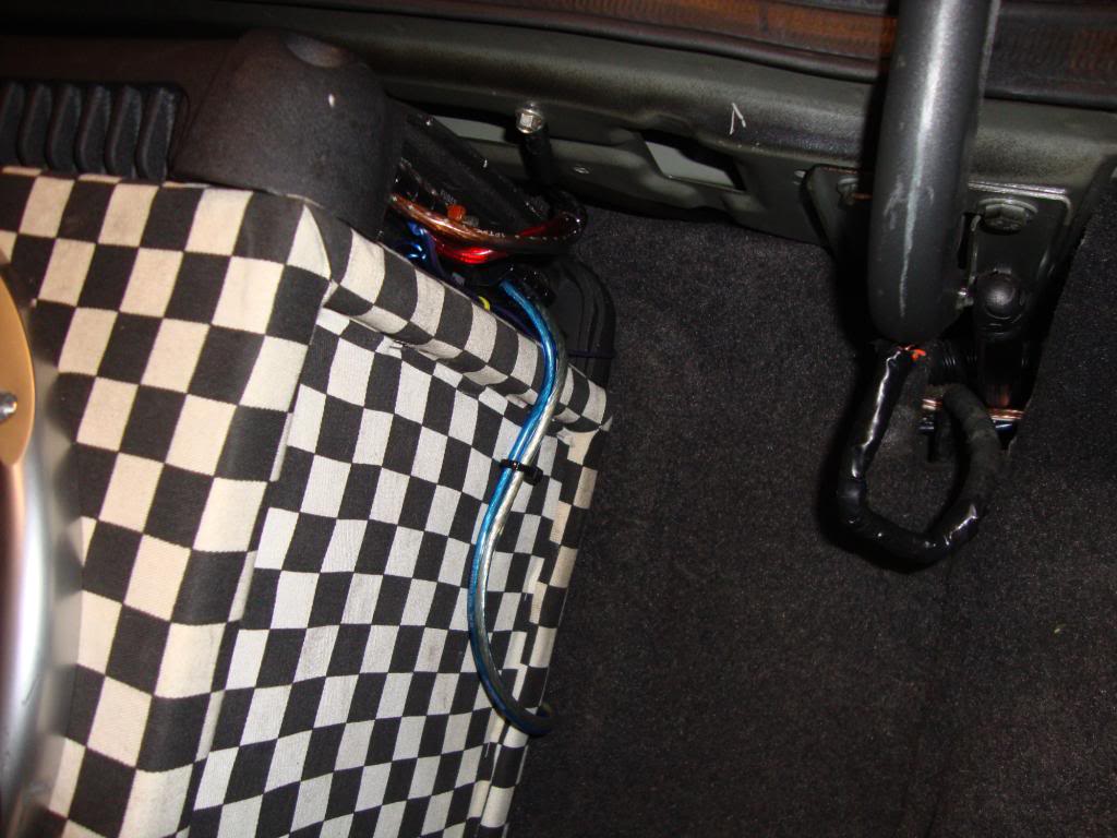

I personally prefer an aftermarket deck, and just run an RCA cable to an amp in the trunk powering your subs of choice.
it's a pain to route the RCA cable without it being noticeable, but I enjoy a good clean wiring job.
I know, laugh at the miserly sony xplodes, but I got a smokin deal, and they have a good sound to them.
I also wouldn't want to be bothered of hunting down speaker leads that aren't there.
I went terribly cheap with my audio equipment, but it still sounds decent for three years later.
Pioneer head unit, Razor 5 1/4's in the doors, the two 12 sony's, and a 460 dual channel amp with the subs wired in series raises a good bit of hell going down the road.
"Also what would be a good location for my ground?"
Jaguar made it easy for us in this regard, I just used the bolts & mount holes for the stock CD changer, couldn't be more convenient.
I had a nice two amp set-up going on to power the door speakers, but that amp blew up, so I just tucked all the excess wiring for the time being until I can source another amp.
