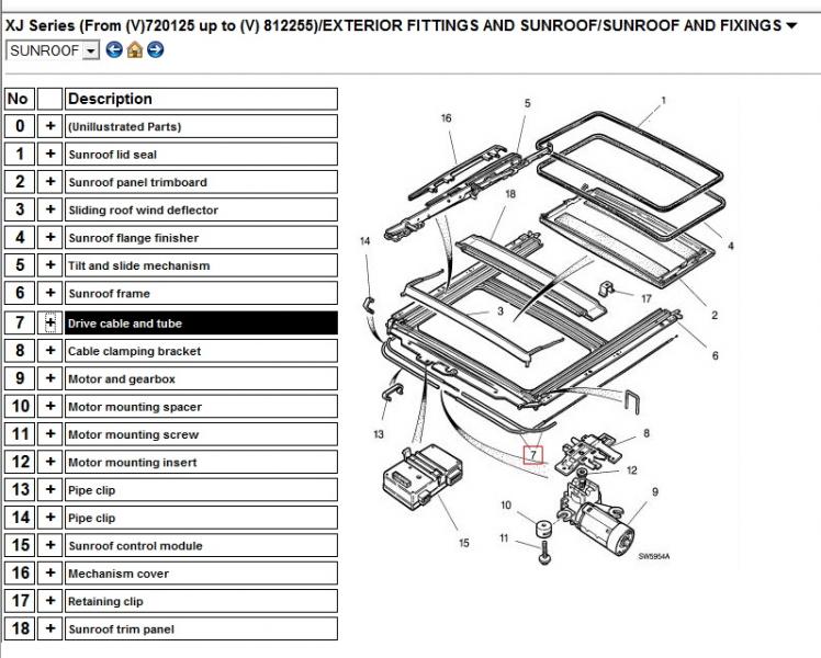

There's a lot of parts packed into a small space. The Parts Catalogue drawing makes the layout clearer:
Only working on one side could be caused by a broken / detached Drive Cable (item 7 in the drawing).
Before considering buying individual parts or an entire Sunroof, it needs to be dismantled to see exactly what is broken. Until then, it's still all guesswork.

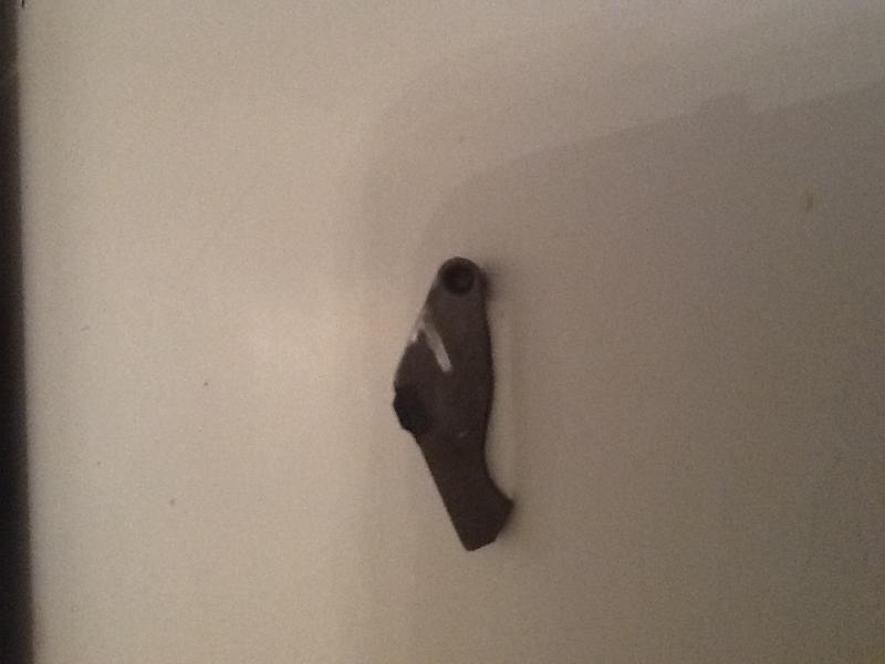

This is the part that broke off. And the sunroof initially broke when I tried to use the tilt feature. And a piece of metal snapped. I tried to attach a picture so maybe someone can identify it.

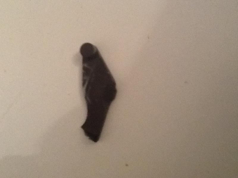

This is the other side of the part

That looks like the end of the tilt/slide lever. It started out about 4 inches long with a pin in the middle having a spring wrapped around it.
They are cast pot metal .. not repairable. That's why they break in the first place.
That looks like a piece broken off the end of the Tilt & Slide Mechanism (item 5 - circled in red).
There's one of these Tilt & Slide Mechanisms on each side. This would account for the sunroof only being powered on one side.
