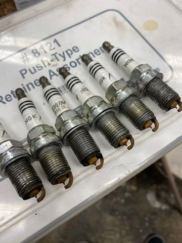

Pulled my plugs after running them for about an hour with the octane booster additive; the tips are bright orange. I've read the orange deposits on the plug tips is MMT https://en.wikipedia.org/wiki/Methyl...se_tricarbonyl and the Internet consensus is, it appears to be effective in reducing spark knock but the jury still out on the effects of MMT deposits on O2 sensors and catalytic converters. I'm also reading the increase by "3 Points" per the claim on the label is 3/10's of a point, raising 93 octane fuel to 93.3
I continue to remain a skeptic of miracle cures in a can, jar or bottle...
