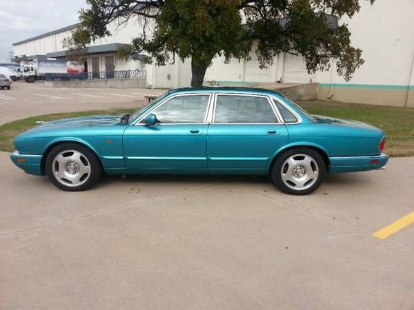

I have been looking at the following 1997 XJR and been talking to the owner. I am pretty close to pulling the trigger.
Jaguar XJR Sport | eBay
We have discussed it a little in the following thread:
https://www.jaguarforums.com/forum/x...eriors-115325/
So far the car and its details appears legit....
The Carfax shows regular maintenance, and the only issue being a minor fender bender a few years back where it was hit in the rear in Florida. This is also shown in the "vehicle report" linked through the auction. Photos of the trunk well do not seem to show any issues where damage had been significant enough to have intruded beyond the bumper. And photos of the rear also look very clean. So I think the rear hit was indeed minor.
According to the Carfax, the car spent its first 4-5 years in Colorado and only racked up about 15k miles, then it went to Florida, and now the current owner has it up in New Jersey since late 2013. He's a dealer that is apprently into Jags, and only kept it for a daily driver while he was looking to turn it over after picking it up at the auction. He says spring is here and he's ready for another XJS.
The photos are very good and seem to show a car that has been well cared for. He says it has a few paint chips on the front bumper, two chips on the trunk lip, and one minor door dent on the front left door that is very hard to see. He says the drivers front fender has a little Sun fade that isn't very apparent, but is there.
He says the car is "fully optioned" and the only thing I don't see are the rear heated seats, which per another thread we have going... 97s may not have had? But that really isn't a big deal, especially since the heated seats seem to give so much trouble. Also the car has no floor mats for some reason.
The current owner has apparently done all the following maintenance, of which I've seen receipts for the hoses and sensors. The new tires and shocks are pretty evident from the photos.

It's missing the front air dam, thats not terribly expensive. It has a slight oil leak from the head, and unless it's just water from washing, it's leaking coolant on to the the engine crossmember.

I really wonder about what appears to be a non-standard steering wheel. This is TOTALLY subjective on my part, but one thing that makes the XJR feel special to me is their darker interior (black steering wheel, darker wood veneer). It makes it feel as "cool" on the inside as it does on the outside. So based on that I would pass on this one. Unless I could find documentation that it came from the factory like that. It's weird because otherwise it looks pretty solid.

I'd be more inclined at $6500 not $8500. Also why are the jack point covers body color?? They should be black rubber unless someone has done a re spray and sprayed right over them. I bought my 97 XJ6L with 60k and immaculate condition 2 years ago for $6000, Values on these isn't really going up. I'd go higher for the "R" but not $8500.

Good catch on the jack point covers. That appears to be overspray. A super easy fix, but it would seem to indicate a fill respray which the seller didn't seem to disclose.

Whoops didn't read that far down....if it's had a re spray I'd run away fast, both jack point rubbers appear to be body color but it may be light trick from the camera.

Regarding the steering wheel, I've found several examples of XJR's with the light wood, trim and "standard" wood steering wheel. I think the wheel with "XJR" versus the Jaguar head crest may have also varied from 95 to 97 as I've seen some black steering wheels with the crest on some XJRs. So that seems normal.
Regarding "Autocheck" versus "Carfax".... not sure which might be superior, but I pulled a Carfax as well and they concur.
The question about respray and the jack points does concern me a bit though. That's the kind of "catch" that is very helpful and I may not have noticed. I'll have to ask the seller about that.
Good eye! I totally missed that. Yeah, that's sloppy paint work.
Not sure how significant it might be. I've had my rocker panels repainted a couple times and they're due again. The wide tires throw all sort of road debris onto them.
All the ones I've seen that didn't have the "XJR" steering wheel pad have been 1997s. Same for the lighter wood.
Al
I missed that as well. Yes, worth getting an answer.
If the car has had a cheapy-repaint then that changes things.

So, I'll definitely ask about what appears to possibly be overspray along the sills, although to be fair it doesn't seem to be anywhere else such as around door gaskets, suspension, etc.. And check out the photos below of the turquoise 95 and this burgundy 97. From the side they both appear to have their jack points painted *shrug*
When the sun comes up, can some of you check out under your XJR/XJ6 and see if this perceived overspray along/under the sills is normal or suspect before I make it a point to press with the owner?
