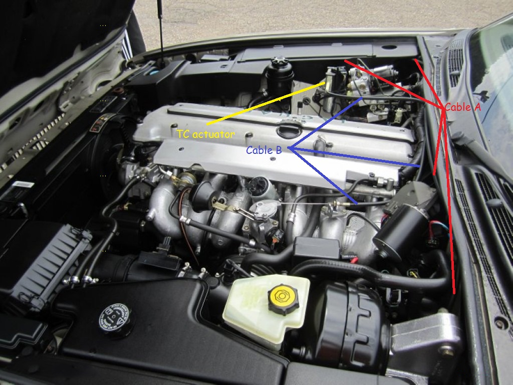

When removing the black plastic cover by popping the 2 upper tabs up you will see the 2 cable ends in the bellcrank that join the 2 cables inside the sleeves . Don't take it apart for it is tricky to get back together as I was cleaning mine . Is it possible to take the " A " cable inside the sleeve exiting the firewall / brake assembly casting and use the " B " sleeve that has the throttle adjustment barrel close to the butterfly . Reswedging the cable end is a question . How to find one outside the aircraft hanger ? Final assembly will be longer then needed . Did the white sleeve positioner break on cable " B " ?

Yes the white piece broke off and the cable came out of the unit. The cable from the actuater is not attached to the any longer
