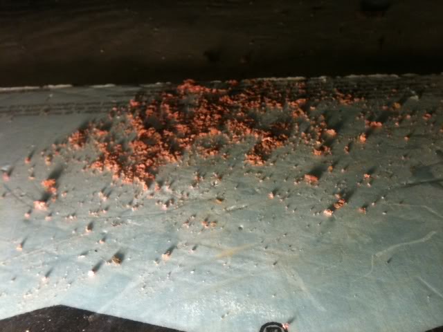

Ok, so it was warm enough and I spent some time in the garage under the Jag this weekend. I found what I suspect to be the problem; on the bottom side of the transmission mount the rubber bushing is completely gone. This leaves a space of about an inch and a half or so that the transmission can bounce up and down when I push up on the front section of the drive shaft. It even continued to wiggle up and down a few times after I stopped. After looking at the diagram of how it works I see there is a spring on the top side (in the parts catalog item #MMC7553AA is what has gone missing). I can see this getting into a resonance and possibly causing my issue, fingers crossed. I will order a replacement and install it on the next warm garage day after it arrives. The Jurid and the rubber around the center driveshaft bearing look to be in perfect shape by the way.

Glad you found that. You have probably found the cause of your vibration since there is not much else that could make a speed independent vibration. The fact that it was true (the part about being unrelated to speed) made the things we all said to look at (including me) pretty much unlikely. Who would guess that your engine. transmission was acting as a tuning fork?
