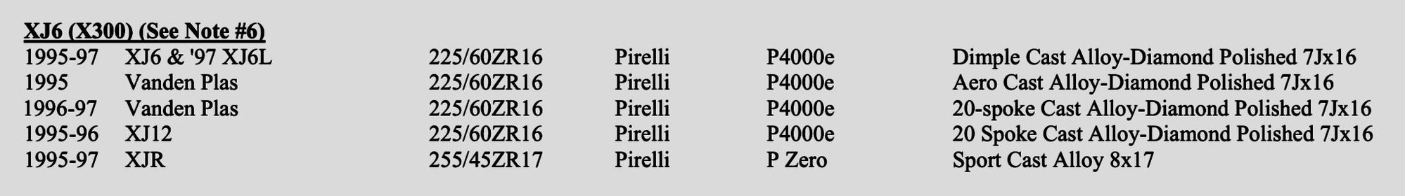

I thought 225/55-16 was an XJS fitment. 225/60-16 for XJ6/XJ12, no?
I have just checked my driver's manual and you are correct. for a 7inch width , the manual quotes that size but for an 8inch width it quotes 225x55x16. I guess I need to put the correct ones on!
