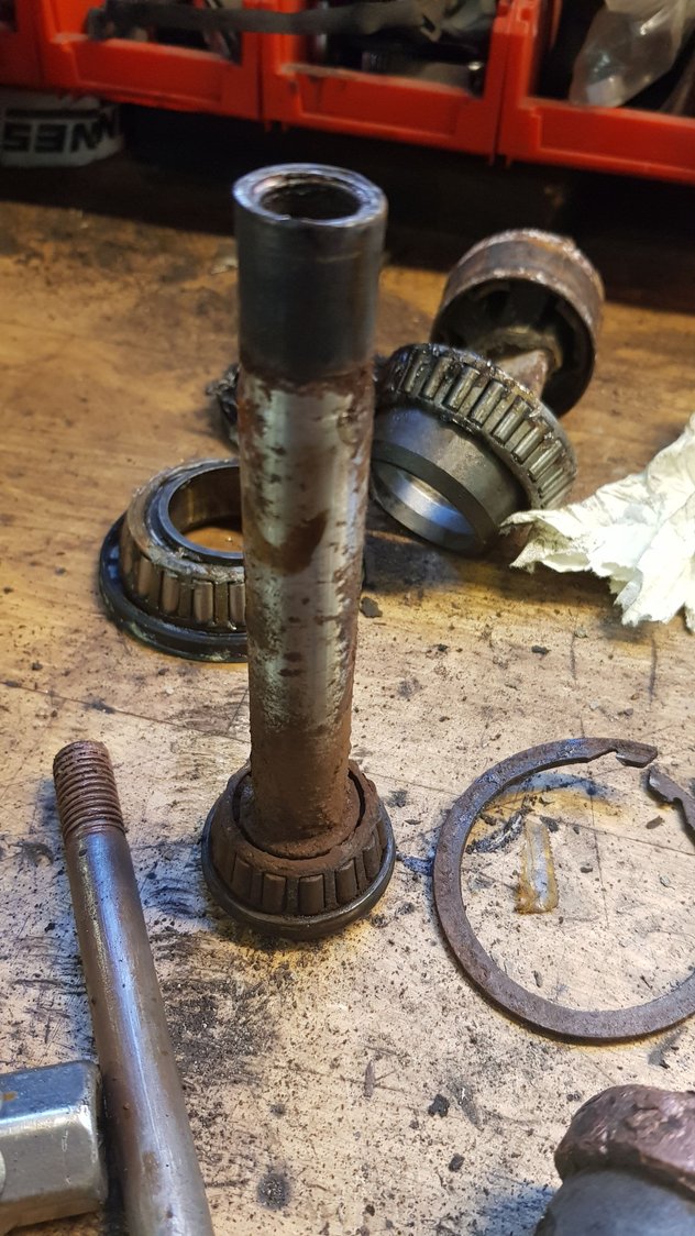

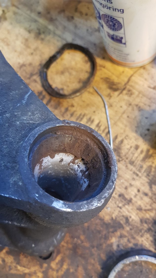

But there was still an issue with the rear end.
It felt unstable and just plain weird. I also started getting some uneven wear on right rear tire.
I purchased new rear bearings and Included the taper roller bearings. Decided to let my local mechanic do the job and it wasn't an easy task as it had rusted solid. The taper roller bearings were just completely dry and stuck. Rusted and impossible to move in any way. The garage spent half a day fixing it but it now feels 100%. Way more stable and just better to drive.
