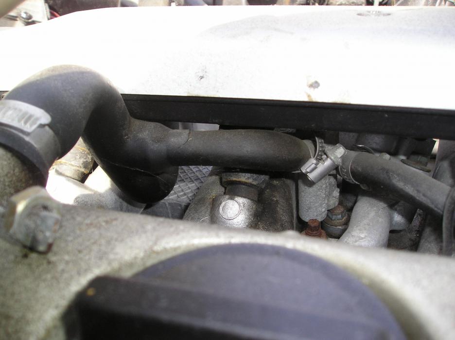

AJ16's don't usually have too much trouble with cam cover leaks unless they are real hard with age or the breather passage is plugged up. The breather passage is at the small hose that tees off of the big elbow hose connected to the left side if the cam cover. It kind of hides under the fuel rail tube. If that is plugged, the crankcase pressure isn't kept in check, and oil leaks [esp. cam cover] can result.

I've seen a hose collapse before, but it's usually the orifice in the housing the hose connects to that plugs up. Loosen the clamp and break the hose loose, then start the engine. If you pull the hose off the housing nipple, there should be good vacuum at the fitting, if not it needs to be cleaned out.

The gunk is probably in the big sections of the hose, trying to clean it out will probably tear it. I'm talking about the breather orifice in the adapter below the EGR Valve. The small part of the breather hose goes to it. See the .pdf for a picture of the hose nipple. If it's plugged, that's the probable culprit for the repeat cam cover leaks.

was it under the egr valve? or right behind it? because I pulled out 2 small hoses behind the egr valve and cleaned out the hose nipple.

The one to clean out is dead center in the attached picture. Remove the hose from the housing under the EGR Valve, clean and rod out the passage to the housing. That's the one that keeps the crankcase from building pressure.

hi did that, and also degreased the engine and will start fresh and look for looks, if that dosent help, what should be my next step?

I think I mentioned this before, but just to be sure....... Leave the clamp loose on that small hose in the picture. Start the engine and pull that hose off the nipple. Check that the nipple has very good vacuum draw with your finger. Then I'll be confident the crankcase pressure will be controlled, and I'll be happy.
