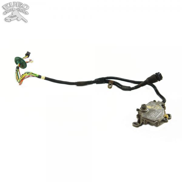

So my mechanic finally figured out the problem. It's the Neutral Safety Switch, at least that what he says from all of this diagnostic testing over the last two weeks. I was really happy to hear they knew the problem, but I almost lost my lunch when I heard the price of over $1000! Thankfully, I did some research and found a used part that is in excellent condition with a warranty on Ebay for $200. That is still a crazy price to me, considering most cars the cost is less than $50. With that said, Jaguar's certainly aren't 'most cars'.

It's not a micro switch, I wish it was though, would be much cheaper. I'm not where the part is located, but here's a pic of the part.

So, my car still isn't fixed. The part I ordered was bad, so I'll be sending it back. Been going through this for 5 weeks now. My mechanic is going to bypass the neutral safety switch and install a start button that will start the car. Also said I would have no issues shifting the gear selector.

From the picture, that looks to me like something known as the "rotary switch", which does more than let the car know whether it's in Park. It also lets the car know which position the shifter is in and, thus, does control the shifting. I became familiar with mine last year when I was having starting problems (which turned out to be the body control module).
Your mechanic is right; that device certainly can prevent cranking. But it's only one of about five things in the electrical path which can.

Thanks tsfo2,
The mechanic said he had tested everything and is certain it is the neutral safety switch/rotary switch....fingers crossed it will be ready tomorrow.
