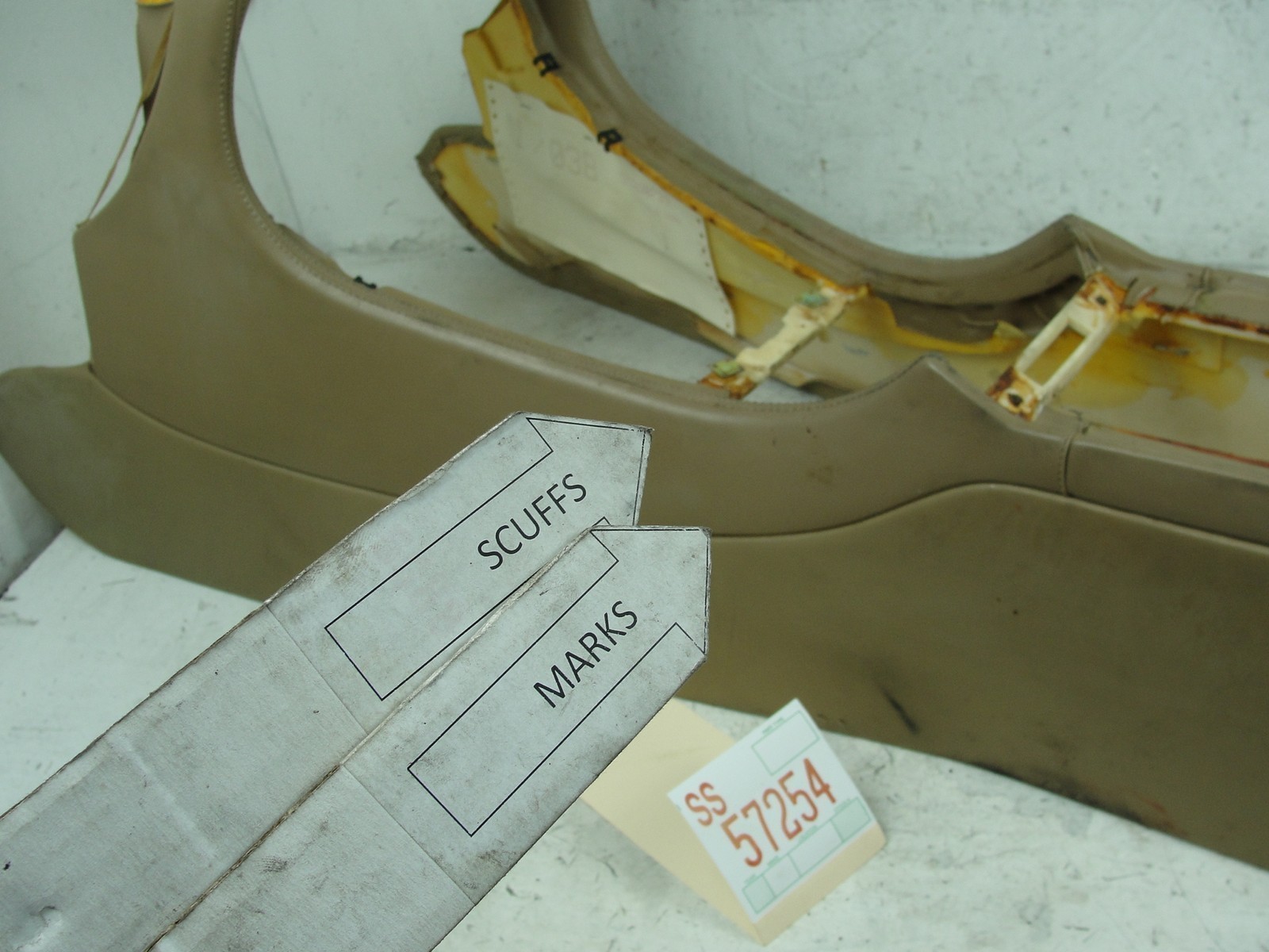

Physically the length & width dimensions of the X300 & X308 armrest are the same, but the hinge & latch mechanism are different. The problem is with the cupholder. The height of the X308 armrest is slightly thinner and the 'holder base' protrudes beneath into the area where the ashtray is located on the X300. If you remove the ashtray, then the armrest will physically fit, but you'd have no trim where the ashtray was. So while a swap is technically possible, I wouldn't suggest it, unless you're capable of some trim work.
For future searchers who might want to try anyway, for mounting, you have to use the hinge & latch hardware native to the armrest you choose, not that which is native to the transplant vehicle. The X300 uses a 3 screw hinge & the X308 uses a 2 screw hinge. So to use the X308 hinge, drilling 2 new holes is required (no big deal since the hinge mount on the console is metal). The X308 latch receiver is a straight swap, no drilling necessary.
Here are pics of both consoles to give a better idea of what described above. If you pay attention to the cupholder area differences, the issue described should be clear.
