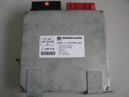

Hello to all, I would like to ask for some help but first I will give the details of this vehicle. It is a 1997 Jaguar Sovereign (X300 ROW, w/ immobilizer) with a 3.2L in-line six, left-hand drive, and an automatic transmission. I came up with the details from searching the internet for information basing on the vehicle's VIN (SAJJHAMG4BPxxxxxx) but if I made a mistake, please let me know. The problem started when this vehicle was taken to a paint shop to have it re-painted. The owner of the paint shop informed me that after the paint job and washing of the vehicle, it would not start, not even crank. They checked the battery and the fuses and found them to be OK. They soon discovered that the engine ECU was wet with water and so they dried it up but still it would not crank. Basing on the information that they gave me, I removed the ECU and checked the connectors for water corrosion but there was none.
I opened the ECU and found it to be very clean with no signs of water damage. So I connected a scan tool to check for DTCs but the engine module did not show up. I checked the wiring from the ECU to the DLC and it was OK. There were no signs of wiring damage in the entire vehicle. I am now leaning towards a faulty ECU, but I still needed to do more tests.
I then checked out the wiring diagram from the service manual and did some voltage checks on the ECU (IG ON to P1105 terminal 33; ECM Control Relay O/P from P1104 terminal 18; ECM Control Relay Supply to P1104 terminal 24) and they were also OK. I also checked the Ground connections to P1104 terminals 1, 12, and 36 and they were also OK.
I also found out that the engine does not directly control the starter, it is the Body Processor Unit that does. Upon careful studying of the wiring diagrams, I found out that the BPU needs to see the Check Engine signal for it to allow the starter to crank. So I isolated this terminal and connected a jumper wire from this terminal to body ground. I was able to crank the engine this time but the engine won't run. The engine needs the data stream from the immobilizer module to release the fuel injection system. I scoped the two wires from the coil on the key barrel and I got some kind of an "inconsistent" waveform (as compared to one from an E46 BMW).
Right now I am heavily leaning towards a defective engine ECU so I need to know if just replacing the ECU with a matching Security ECU will be enough. Or will I need to have a matching BPM too.
Please help me out.

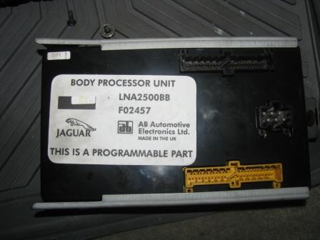

On another note, is it possible to replace this with an engine ECU that has no immobilizer function? I have attached photos of the actual ECUs in the vehicle
Attached Thumbnails X300 ecu-engine-ecu.jpg   X300 ecu-body-processor-ecu.jpg   X300 ecu-security-ecu.jpg

Well it certainly sounds like your ECM is fried. Might be difficult in the Philippines but if you can get hold of another ECM to test that would be best.
Does your car have 4 O2 sensors or just 2? That would make a difference in what kind of ECM you could use. Also not sure if you would need another SLCM as I believe it provides the immobilizer status?

This particular Jag has only 2 O2 sensors and yes it will be difficult to get a hold of another Jaguar ECU here in my province, but I can get one from online sources, I just need to know if I will need another BPM or a BPM + SLCM. I checked again the electrical wiring diagram and found that the immobilizer only sends a locked/unlocked status signal to the BPM, which I think is only for the doors, windows, etc. I don't think that this signal has anything to do with the fuel injection. On the other hand, the signal from the immobilizer to the engine ECU is the one that releases the fuel injection system, allowing the engine to run or not.
My thoughts: If I use an ECU that has no immobilizer function, then I may be able to run the engine because in this case the fuel injection system is already released (from the factory). Problem now will be VIN matching of the major control modules in the vehicle if VIN matching is designed into the system (allowing the vehicle to run or not). Any thoughts on this from the Jaguar specialists?

There is no matching between BPM and ECU and SLCM. All units are independent of each other. There are lots of threads where people have swapped out the engine ECU (usually as a result of bad advice from a mechanic), and I personally have swapped a BPM on my car.
It sounds as though you know what you are doing and have done some excellent diagnostics already so at the risk of being patronizing can I just ask if you have checked the inertia switch has not been triggered?

...been busy with another vehicle the past week. I have checked the inertia switch and it has not been activated. To make sure, I checked the wiring diagram again and saw that power from the battery goes to the inertia switch, which in turn supplies power to the heel board fuse boxes. I have power to both heel board boxes.
Regarding the replacement of the engine ECU, what do I need to match (aside from the basic part numbers) for it to be compatible with the vehicle? The original ECU's part number label reads:
3.2L N/A
LNB 1410 BB/2--
GEMS 6 CONTROL UNIT
Type Code AA/2--

I am thinking about this one: for a matched pair of engine ECU and SLCM, the SLCM sends coded data to the engine ECU to release the fuel injection system. What I do not know is if this coded data is specific to the matched pair or is it a "generic" data that any engine ECU can read and thus release the fuel injection system. I have found this (JAGUAR X300 3.2 XJ6 GEMS 6 ECU CONTROL UNIT SAGEM-LUCAS LNB1410BB | eBay) and it matches perfectly aside from the Date Code

@Urchins: Yes, I have seen some listings that included the barrel and key, the reader module, and the engine ECU. Since there is no PECUS label, I think I may go for the one with the 211 suffix, as this vehicle has an auto tranny. On a side note, I am not new to this sort of thing as I have done ECU swaps on other makes of vehicles using ECUs purchased online, the latest of which is a MRSZ5 module for an E90 BMW. After installing the module, lots of errors showed up in ISID, with the most significant one being "coding does not match". I merely recoded it with ISID and all was OK. The thing that is holding me back on this Jag is my lack of information on what I need to look out for. I know that I have been shared a lot of information already but I still feel that I need more, especially regarding the immo function (coded binary stream between a matched pair? or does the SLCM simply supply a ground signal to the engine ECU's fuel injection inhibit pin to release the fuel injection system?).

I think you are over estimating the sophistication of the X300 electronics. Don't forget this model is 20 years old now.
I have Jaguar IDS system and have used it to re-program X Type ECUs amongst other things in the past. As far as I know there are no options for re-programming or re-loading the ECU for the X300, or for matching the ECU and any other component.
The ECU should just be plug and play as long as you get the right part. As an example of a thread where an ECU was replaced without any other coding see here
