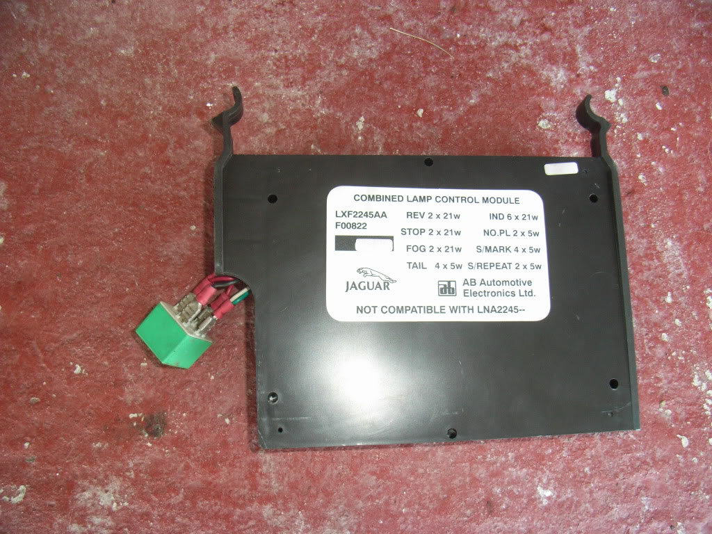

My XJ6R has X308 bumpers. The lights are the only difference. I have a double speed flash on the left side that I havn't been able to fix - although I've had plenty else to keep me occupied and it's never failed an MOT. The front fogs are not wired in either - not connected at the back of the lamps. Never failed MOT with that either and the bulb warning on the dash doesn't light up through lack of fogs, only on the double speed left indicator. I'd be interested to see how you get on and if all I need to do is check wiring.

Is the radiator grill not slightly more rectangular on the X300?
For a double rate flash, if your indicators otherwise work, try changing the bulb for a fresh one.

Yes, the grille is different. I can't say it messes with the bumper though and I should know as I have replaced my grille. I'm sure I've replaced the bulb/s - trouble is it was so long ago that now you've go me thinking maybe I didn't. One thing I did notice, and it may be something to do with the bumper change is this:

I actually swapped the bulb module with another but still the problem of the double flash persisted. Anyone shed any light on what is going on here as it may help the OP as well as me?

The question about the grille was just to find out. The X308 has a great "snout" but the X300/R has that wonderful supercharged inline 6 sitting in the engine bay.
some thoughts:
- the lamp module carries the designation "not compatible with LNA2245--", is that a material difference in your circumstances?
- on the X308, the front directional indicators are operated by the BCM and not the lamp control module in the trunk. Is that the case on a X300?
- the X308 and X300 *may* use different bulbs. in that case the controlling bulb monitor would expect to "see" that bulb in the circuit
- are the ground circuits good?

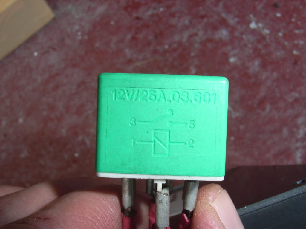

- the relay pictured is a generic relay. Jaguar relays generally have a internal EMP suppression diode between pins 1 and 2 to protect the driver circuit.
Anyways, the double rate flash sound is actually quite pleasant
Just checked the parts website, LNA2245 is up to VIN 739426 and LXF2245 is from VIN 739427 so that's ok with my car.
I believe the x300 is also controlled by Body Processing Module which is behind the glove box on a UK RHD car.
I know the x300 has 2 bulbs in the front bumper indicator while the x308 has only 1 bulb. So in my car, the x308 indicator has only 1 bulb, it now has the x308 bulb holder where the x300 (twin bulb) unit has been cut off. I'd have expected this mod to produce double speed flash on both sides though.
Absolutely no idea on this one. This is one of those jobs where I have the luxury of gaining plenty of advice on this double flash issue from those more experienced than me. There are usually more pressing jobs to be done I'm afraid.
Many thanks for the input - when I get around to it I should start with checking the wiring & grounds.

@straightdohc6
The double to single bulb may be of great significance.
If the original circuit was 2 bulbs in parallel, the expected resistance is half of a single bulb. If a series circuit was used, then double that of a single bulb.
Running a different bulb type also introduces a change.
A corroded ground circuit will also introduce a change.
The reason that only one side is double flashing is that the good side still remains within system tolerance.
Your best bet is to measure the resistance of each circuit. The difference will tell you which direction you need to favour.
