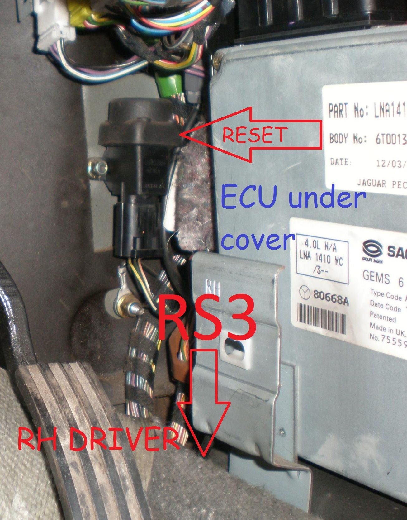

there is an inertia / crash switch that can be fickle and kill the engine
there is a reset bulb on top but does not always reset from reading others , do not disassemble as parts fly everywhere
with a paper clip you can jumper the 2 white wires on the connector
this is a pic of someone's right hand steering model , and the switch will always be on car's far right

Inertia switch disables the fuel pump. If you’re getting fuel, the inertia switch is not the problem.
