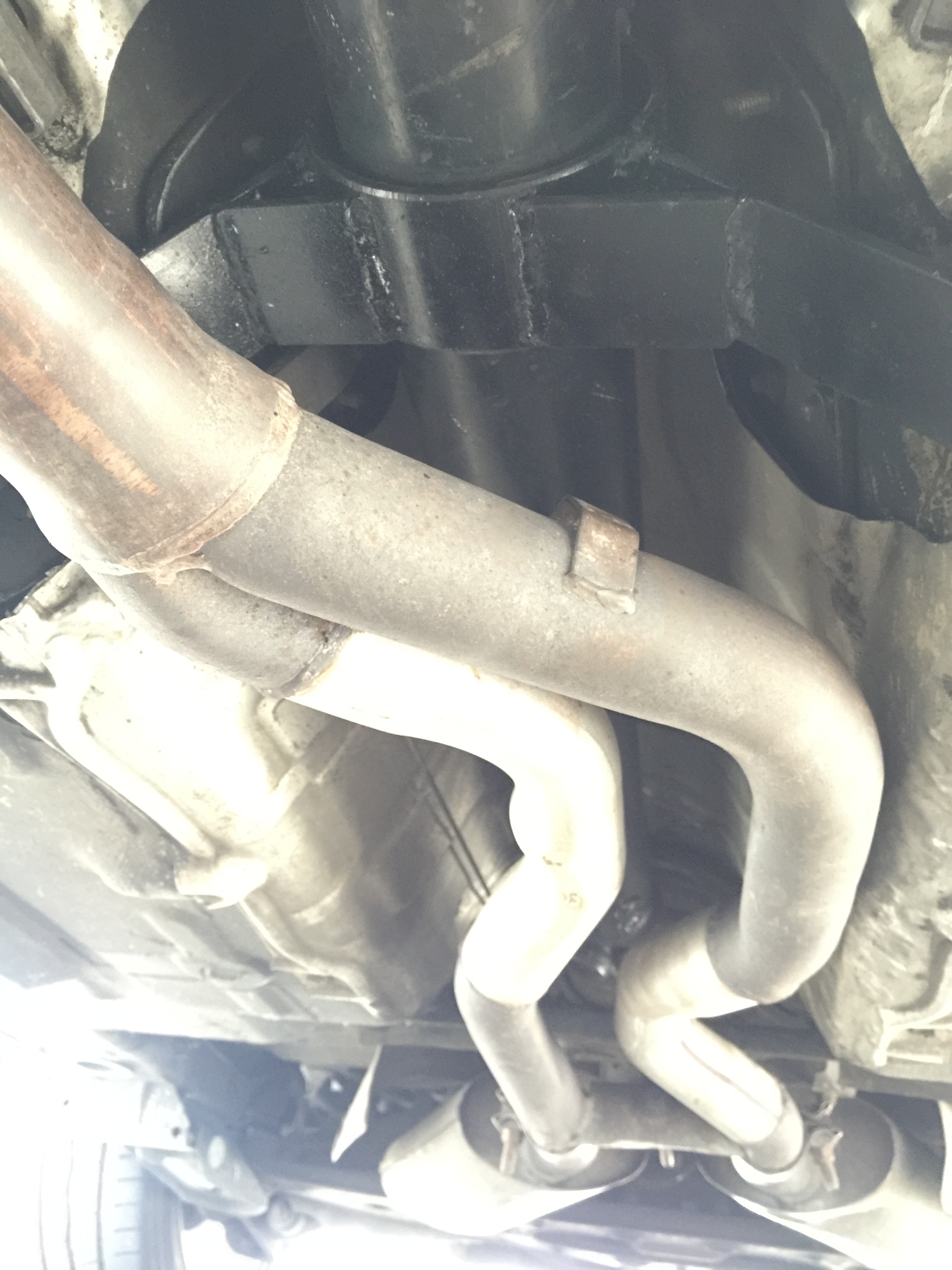

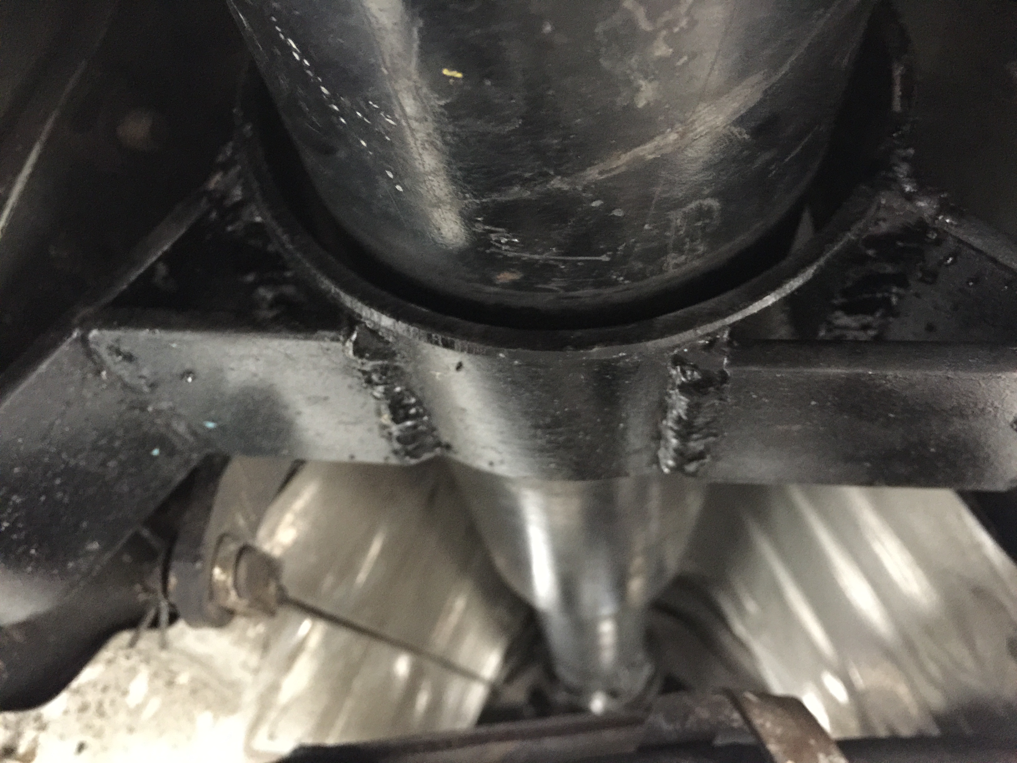

So the front seats came out and a custom yoke fabricated and fitted around the front end of the driveshaft, as per pics.
The car is finally certified and legit again.
But they had to cut the exhaust to fit the yoke and re-fit the shaft, and also cut away some of the original heatshielding. The new sections of exhaust (pics) are not mandrel-bent and are somewhat flattened on their bends, which is making a small dent in power I think. Hmm.
And now, when I floor the little right-side pedal in 1st or 2nd gear, there is an unholy noise from beneath the floorboards as the drive shaft rubs on the (unnecessary) yoke, and a small groove is now on the circumference of the shaft where it rubs on the yoke on full throttle, presumably as the engine/gearbox shift a bit on their mounts. Ironically, this could ultimately lead to driveshaft failure.

I saw your photos of the yoke before I read your post, and I did wonder how it was going to perform. On the odd occasion in the past when I came across yokes on propshafts, they tended to have a much larger circumference, and have a flexible rubber center, which didnt seem to contact the propshaft at all, at least not in the stationary position. I never had a problem with them, so didnt interfere, or spend too much time wondering what they were for. Your thread has prompted me to conclude that they were primarily for limiting or damping propshaft flex, and ,in extremis, catching the propshaft once it broke.
As you have now discovered, the trick seems to be leaving a bit of clearance to allow for normal propshaft movement....

Interesting to see how the authorities sometimes over-manage with the ultimate aim of protecting themselves for tolerating vehicle modifications. In contrast, the U.S. seems to be a haven of vehicle modifications where it is not uncommon to see Jaguars running with Toyota or GM engines. This issue aside, I agree with countyjag's observation. If your driveshaft is not original maybe it needs to be calibrated or aligned to reduce the vibration that may occur during high speed. Here is an earlier thread in this forum that talked about driveshaft alignment. Wonder if it helps.

there is no issue with driveshaft alignment or balance. No vibrations at all, right up to 125mph.
the problem is occasional rubbing of the shaft on this new yoke - not enough clearance, and some torque movement of the engine/gearbox on the rubber mounts under full load in low gears.

I just had my car back to the mechanic who did the driveshaft yoke.
I have done 10-12000km since this yoke was fitted.
I have had two problems with it - (1) shaft rubbing in yoke, (2) thumping under car under hard acceleration in 1st, 2nd, 3rd gears. I had thought problem (2) was from exhaust hitting floor with engine twisting on mounts.
Today the original mechanic bent the yoke so it doesn't rub any more. he couldn't work out where the exhaust was bumping.
On the way home I tested it out a bit in first and second gears - no more thump. I think the drive shaft was hammering against the yoke. So that is two issues solved
I still don't like the narrower sections of exhaust as shown in the original post pictures.
However I want to get some extractors/headers made up to Andy's secret specs, and no point doing exhaust work twice...
