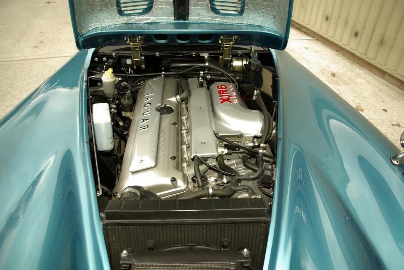

XJRengineer, I've briefly read through all of this thread, so apologies if this has already been covered.
I'm looking at putting an AJR6 engine into a completely different car.
I have previously done this but was fortunate to have an ECU supplied by Jaguar with no security codes on it.
Are you able to modify an ECU to remove all the security from it, so it can be used in a different vehicle?
Old May 9, 2013 | 01:57 PM
  #65
XJRengineer's Avatar
Posts: 838
Likes: 694
From: UK
I was once contacted by someone involved in the build of the car that you menioned. As you write, you were very fortunate to have a non-production ECU for that car which enabled it to run without the std X300 security ECU. I can programme ECUs to run XJR6 engines in conjunction with manual transmissions, without the security ECU. I don't know how such an ECU would work in conjunction with an automatic transmission, if this is what you intend to use in.
I may have a solution if your intended vehicle will use an automatic transmisison, but I'll await your confirmation of the transmission specification.
Old May 10, 2013 | 02:46 AM
  #66
NostalgiaCars's Avatar
Posts: 2
From: UK

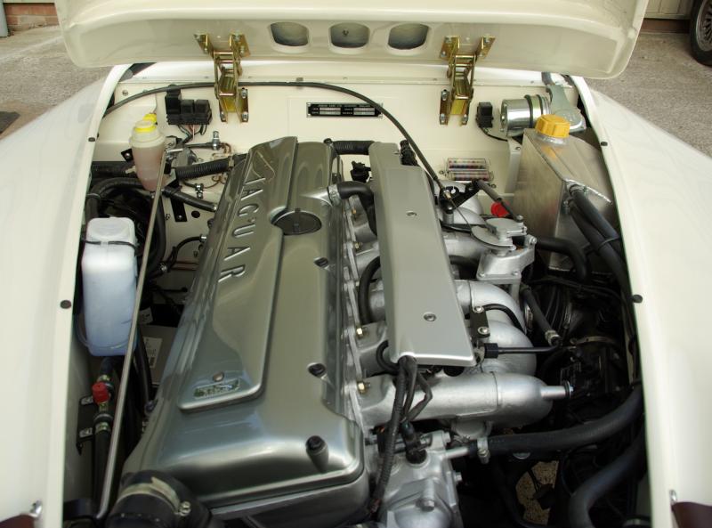

Here's the bay of the one we previously built:
We have also built one with an non supercharged X300 engine, and managed to get this one running by sourcing a very late XJS ecu with no security on it:
Both of these were Automatic
I would like to build a manual XJR6 powered one now, as I have a manual XJS gearbox I should be able to use.
