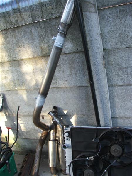

2.5" from cat to axle, then 3" back, no rear boxes - custom from Paramount Performance. Sounds good and adds torque.
Boxes? Mufflers? Can you share some pics of your setup?

OK, here's a few off the car before I tidied it up with a rotary...
I've just ordered F.I.A race cats
btw - fit the gearbox connector heat shield!
Attached Thumbnails The 1998 XJR 4.0 to 4.2 engine swap thread !!!:)-dscf4317-medium-.jpg   The 1998 XJR 4.0 to 4.2 engine swap thread !!!:)-dscf4318-medium-.jpg   The 1998 XJR 4.0 to 4.2 engine swap thread !!!:)-dscf4677-medium-.jpg

yeah I have 2.5 from cat all the way out over the axle out magnaflow sounds great and added a bit i think maybe just the sound makes it feel faster LOL, Cant wait till my buddy gets done with the new step manifolds and downpipes. Gave up on the headers too restrictive to get them fit right and flow well
