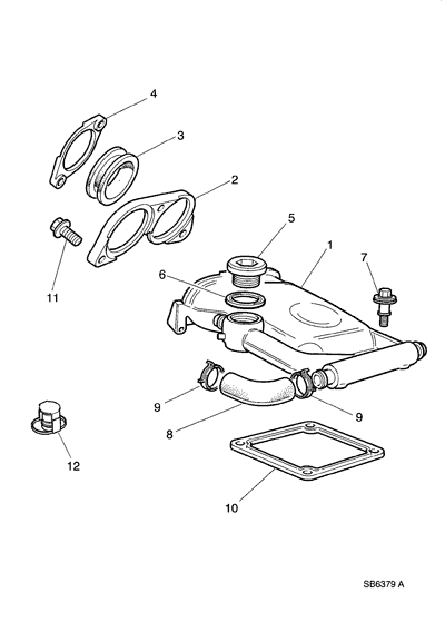

I'd forgotten there was a tsb on the earlier outlet ducts seals, the updated version have a sealing lip to stop leaks. It could require this #3
As Andy pointed out it's a good thing to check the rotors and valve, but also the gasket, as these can leak also #10
The boost valve is spring loaded if disconnected the butterfly stays open. Don't think I've seen a bypass actuator fail, so it could well be disconnected.
