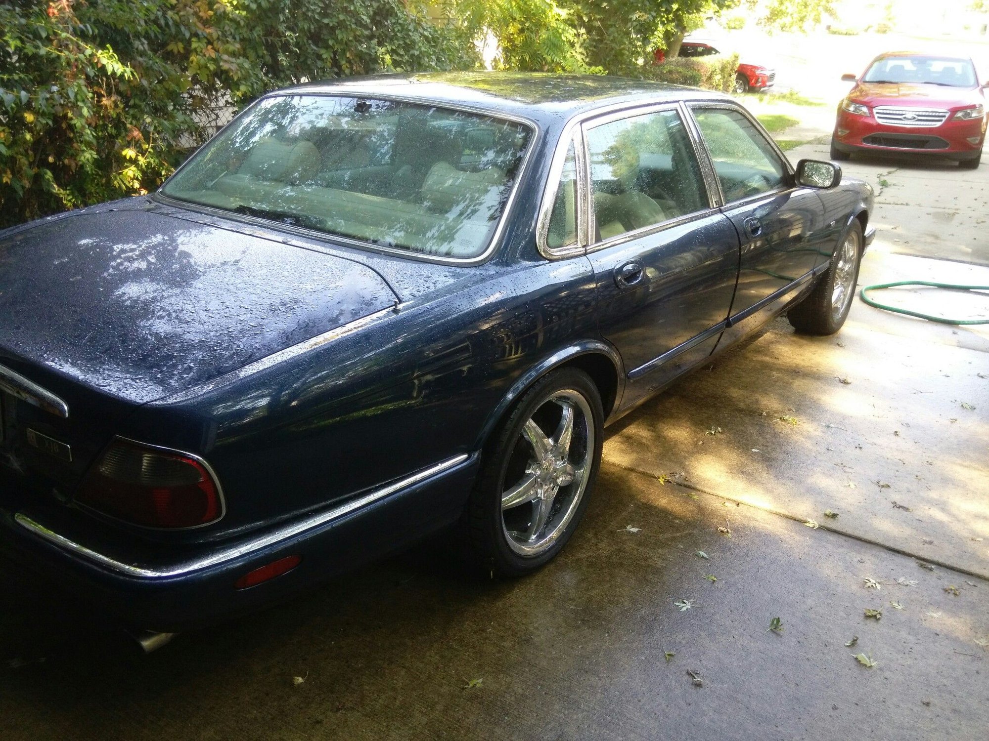

I have a 99 XJ8 82,000 miles that has been sitting in my garage for a couple of years. I got it running today and notice this knocking on the driver side. I attached a file of the knocking
Picture of car
