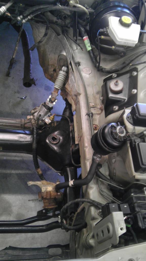

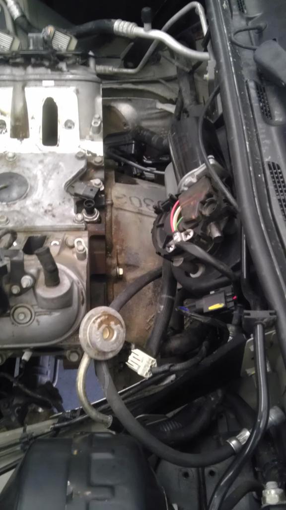

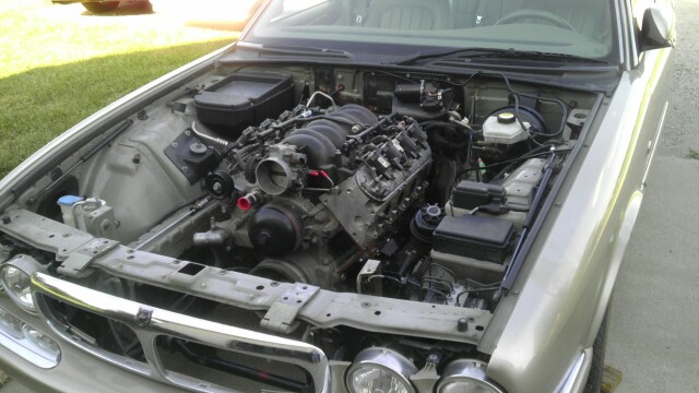

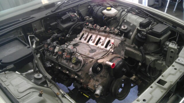

As it sits now.
Plenty of room.

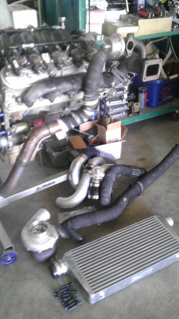

New turbo toys.

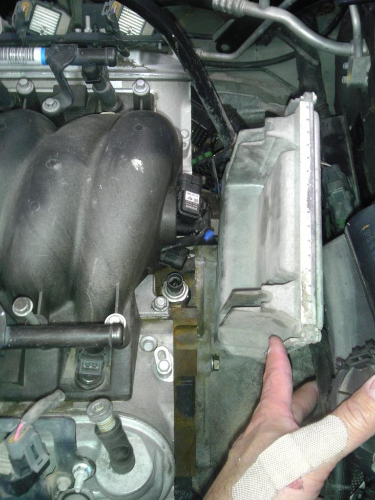

PCm mounting area.
Front end raised up nearly 2 inches from original motor to iron 6.0L and 4L80e trans.
Plenty of room.

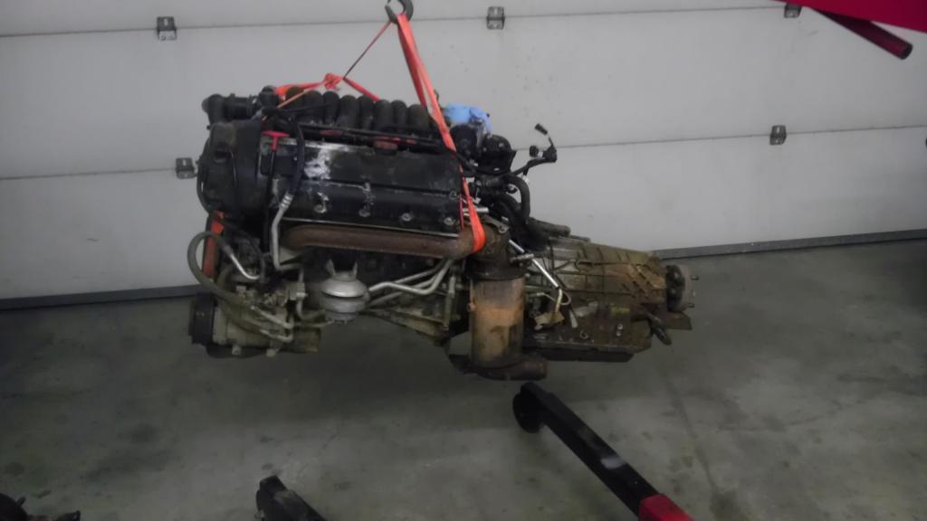

Underpowered carcass boat anchor removed.

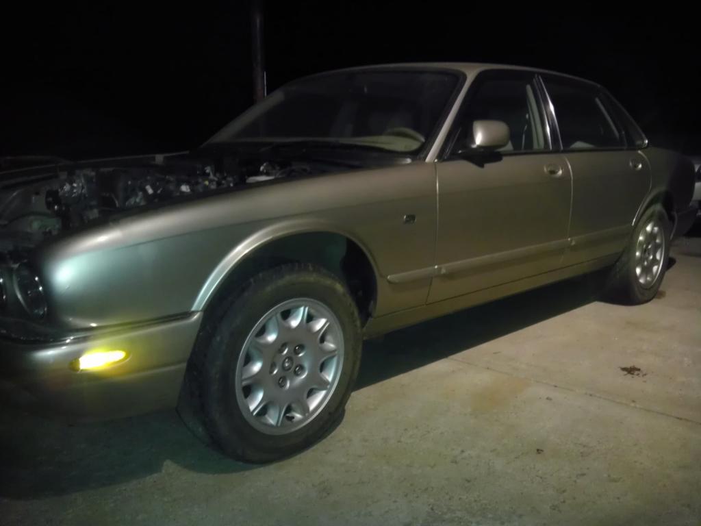

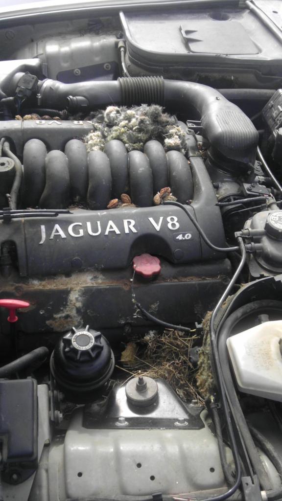

As I got the car.
Yes it's about 100 peach pits and a dead rabbit.

cool job, keep us up to date - definitely want to see this car run by the way, have you still got the 'boat anchor' as the TB would be useful to one of our members I guess the extra height is without ancillaries, rads and fluid. Quaife do a drop-in lsd for the rear.

I gave the motor to a buddy who will likely just let it sit or sell it for scrap. Trans was slipping badly is why i got it for very cheap. Another buddy did an aluminum LS1 4L60e swap into an older 1994 jag coupe and added 1 inch spacers to lower the spring paocket under the a-arm. The iron block adds 100lbs and the 80e is about 75 more too. I am not thinking it will drop much with everything bolted and filled with fluids.

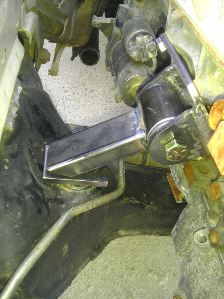

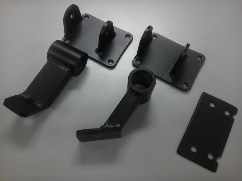

Got motor mounts back from powder coater today. The paddle end with small hole will have a 1/2 inch allen head bolt going down through it then through the frame and a nut on bottom. Black urethane bushings keep it tight and clean. Flat plate is bolted to top of cast aluminum trans crossmember then bolts to trans tailshaft and Urethane trans mount. Will post pics of layout soon as I pull it apart. Waiting on $$ to buy Isky tripple 12 cam; should be sometime next week.
Here is where I am going to mount the PCM.

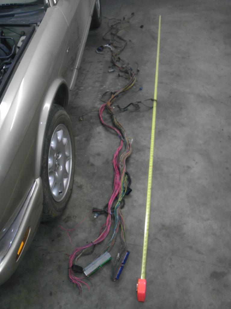

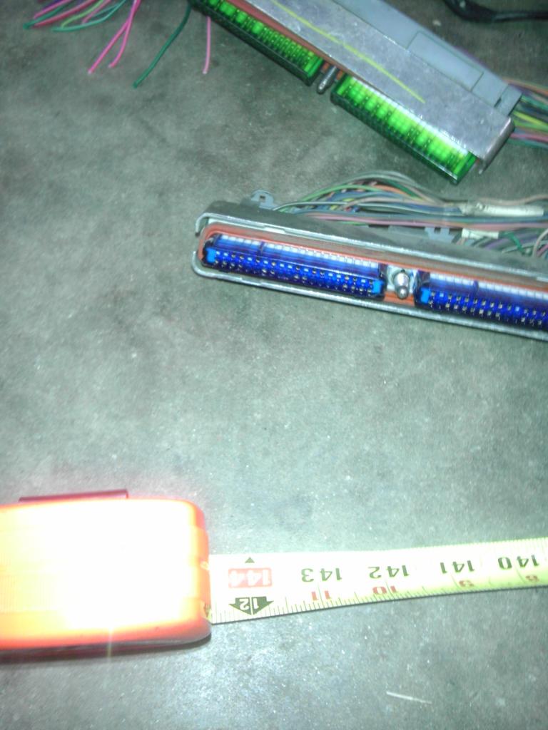

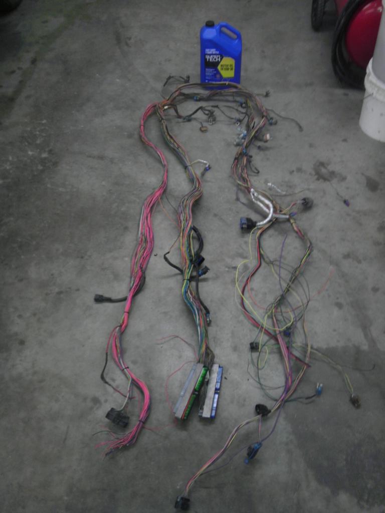

Van harness measurement. Think I will shorten it a bit. Eric suggested I place PCM in trunk. ;-)
Snakes ! Thats a gallon container of oil not a quart to show size relationship.
Literally 12 feet long van harness
Driver side frame rail and engine mount through frame hole

You do good work sir! May I ask if you had the motor mounts modified before sending to powder coating? That's the only question I have.

I made them myself. They are no where close to the factory design. Very strong and simple to clear the turbo down pipe.

I must say you do good work sir!! Looking at the pictures I was thinking, "Those aren't factory or any aftermarket I've seen". I'm thinking you should have made at least 3 sets for those who might decide later to do the same swap. I have a '66 Mustang inline 6 and thankfully so many have done a v-8 swap to make it easier to source the right motor mounts. I am sure there will be others who will want to do the swap once their engines take a nose dive and they want the power boost. Once again "AWESOME THREAD!!"

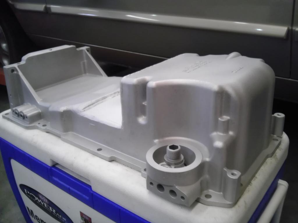

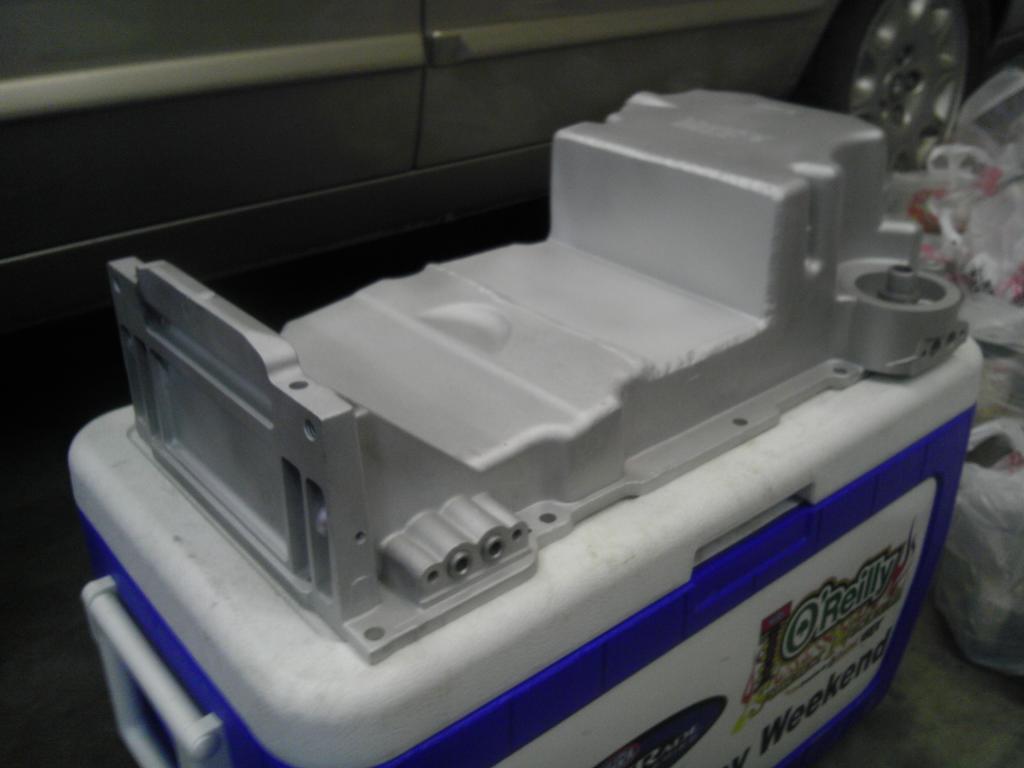

Little update. oilpan TIG welded and glass bead blasted. need to clear coat it and save pennies for my cam :-)

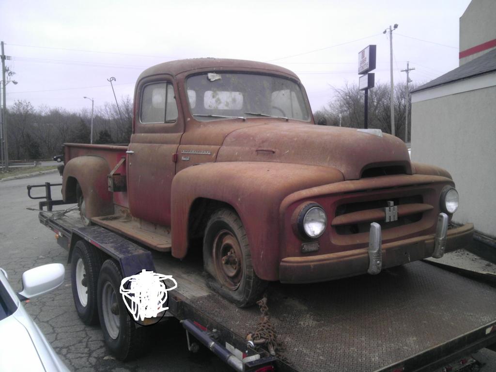

buddies project '55 international truck Likely go 6.0L turbo Mustang Ii front end and Camaro rear. :-)

I'd bloody love that truck - what do they cost?
Old Dec 10, 2013 | 08:27 PM
aknovaman's Avatar
Joined: Sep 2013
Posts: 21
From: Tecumseh
In that shape typically $1500 to 3500 USD for a chevy model. International is not as desirable so less. Chevy weighs about 3400. And these are over 4000 pounds. This one is totally rust free except under front headlight and been stored indoors since 1972. Owner got this one from an old farmer that is a close friend too.
