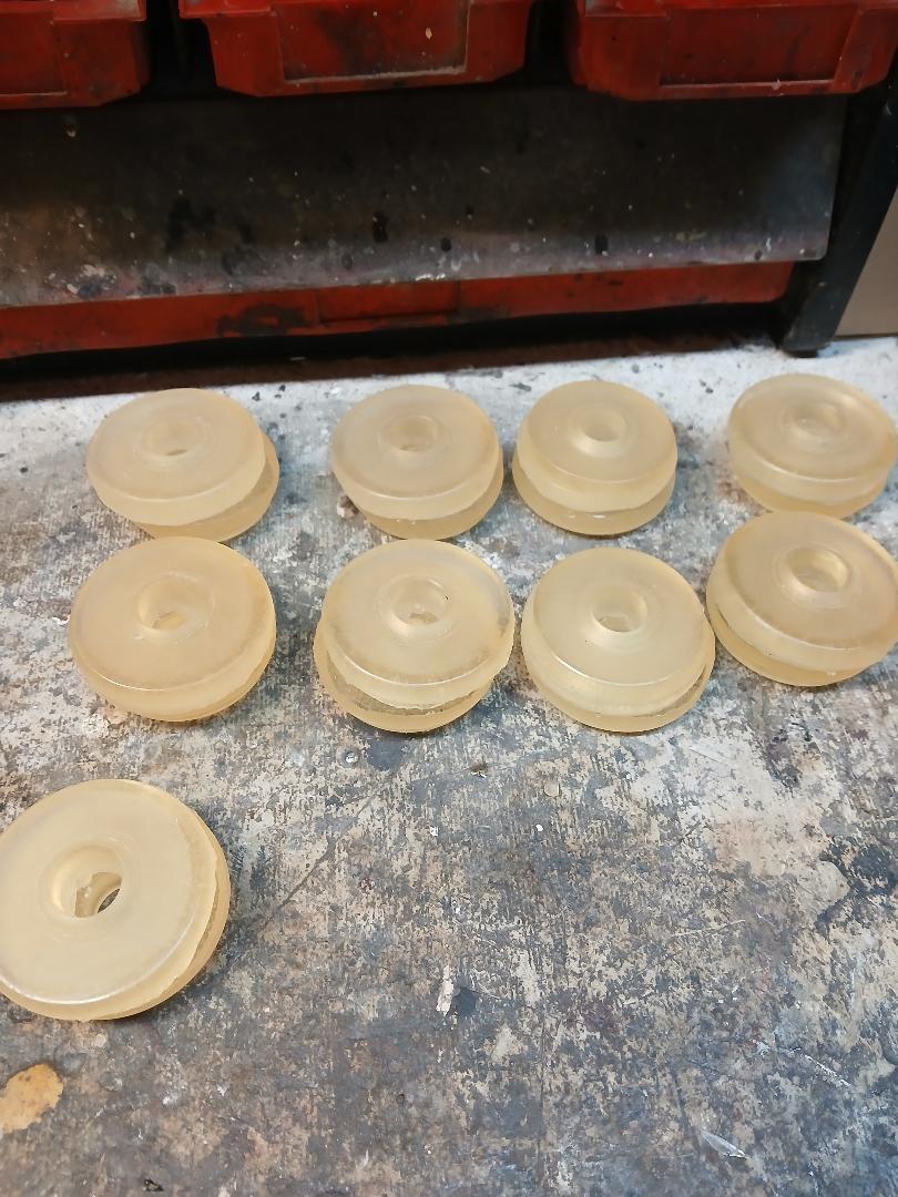

Yes these are made from a proven flexible polyurethane that I've been putting on the xk8 for nearly 3 years now.
They replace the dissolving ones That URO and others make. You'll never have to do this job again!

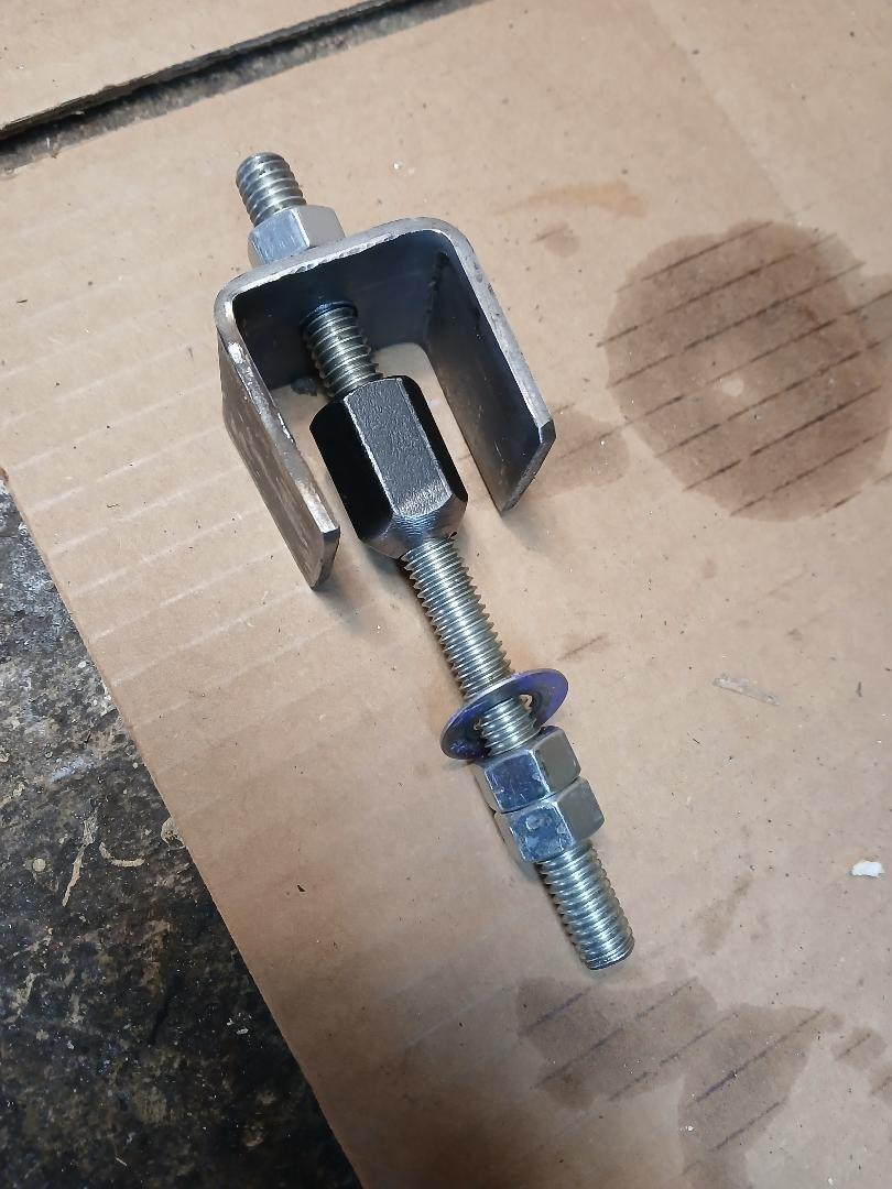

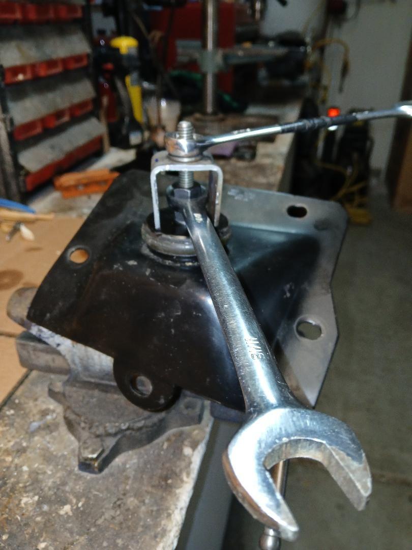

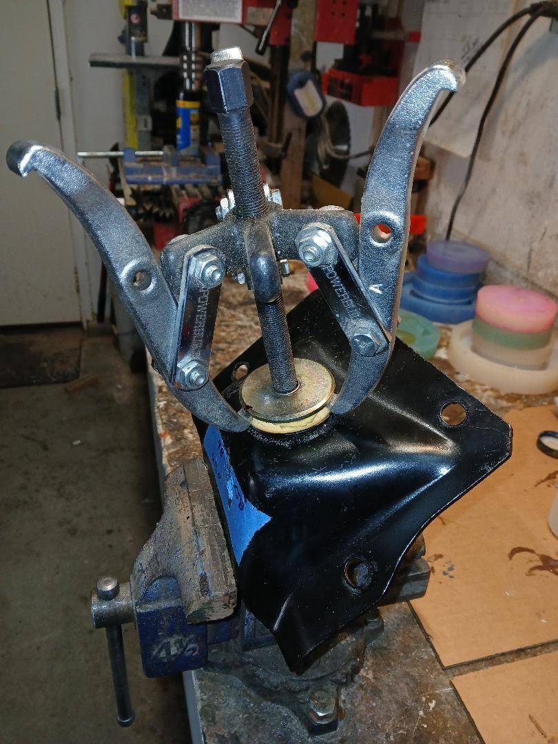

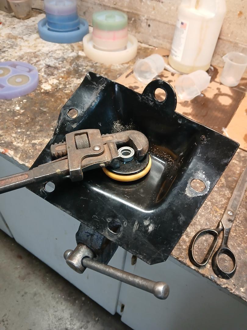

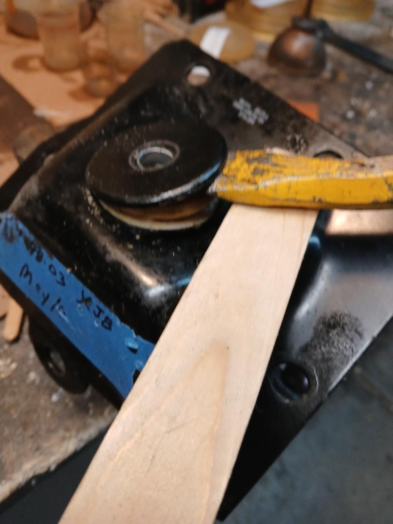

They easily pry apart with a crowbar, once you get the top plate moving by holding it in the vise and twisting the body.
I don't have a press so I made this assembly tool. Pm me for payment and shipping details!
