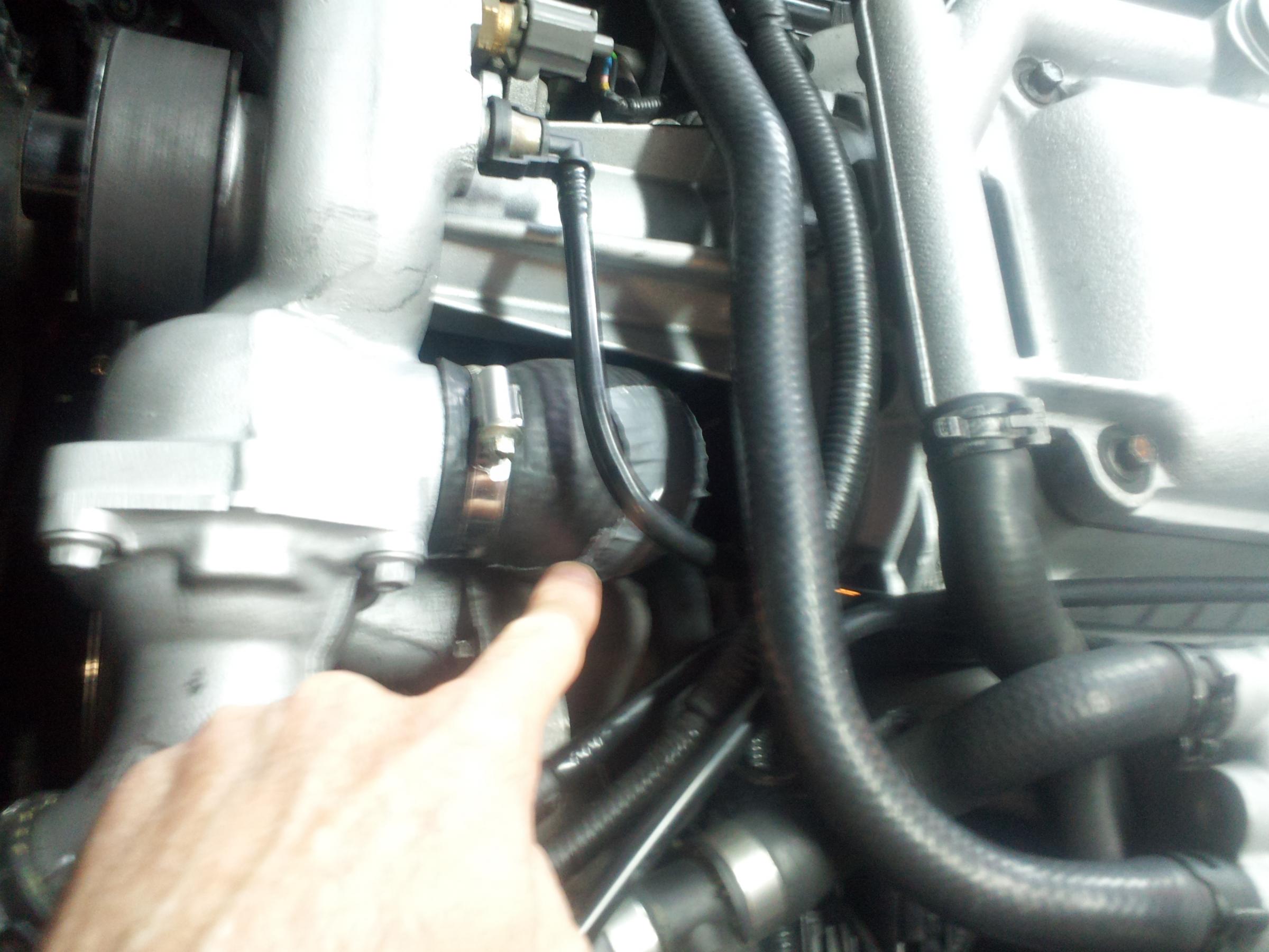

What is this hose called? Or better yet, what is the part number for this part?
Or even better yet, anyone want to come over and bring this part, install it, then take me to dinner? I promise I won't wear nylons with runs like the "lady" in "that other post"
Mine spring a leak-hence the Fancy duct tape patch which helped me get home with no leaking

Mine is the XJR supercharged version so this attaches to the cross over tube. IS yours supercharged, or is it a different part for yours?
If Welsh doesn't rush and send it via personal courier/mechanic on the very next flight to SFO, then come over and hand install it pronto, I'm going to put up a poll about it!

I think I need part # W0133-1631010 for the xjr. I'm checking local dealers now...
HAH! local dealer wants $59! NOT!
Just ordered it for $17 online. Rather than drive with fancy tape on the hoses, I'll just take the other jag tonight for our 16th wedding anniversary.

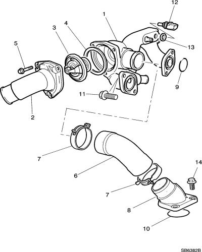

#6 AJ88713
Attached Thumbnails 2000 Jaguar XJR, What is THIS hose called or part # ?-sb6382b.jpg

Did that part end up working out?
Old Jun 17, 2014 | 10:30 PM
WaterDragon's Avatar
Joined: Jun 2012
Posts: 1,761
Likes: 279
From: Los Gatos, CA
Yes, it was perfect!
