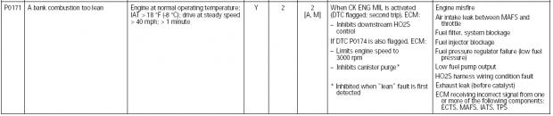

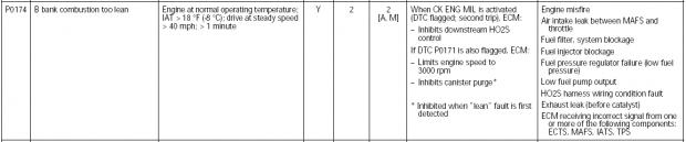

I would like to see a little history of your car, year (2000), mileage, was the car in storage and when did all this take place. As in tjcpt1 post he found a cracked and leaking hose under the manifold and did a little housekeeping. The common problem has been hose leakage related and or TB and MAFS.
Give us a little information (history) and we will try to help!
Attached Thumbnails 2000 XJ8 CEL on/ restricted performance-p0171.jpg   2000 XJ8 CEL on/ restricted performance-p0174.jpg
