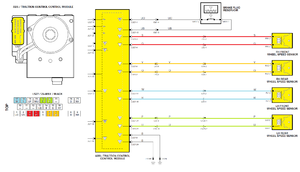

Important point Sean B brings about the full battery charge as you tinker around as the ECU's don't operate correctly .
Brake faults may resolve themselves as you let them play out as you drive . Brakes are safe to drive with . True on the common C1905 code but before you go down that path there are easier paths to check out being one of the 4 wheel speed sensors being out will cause all the brake faults . You can read the sensor wire pairs in a fundamental electrical sence with a common meter to see if one is out . The way they work electrically is different but this fundamental way will give you some information . Just pull the ABS connector and read if the resistance is the same for each wiring pair ( 1300 ohms for the X300 ) .
You won't have to concern yourself with this as they may correct themselves .
Fuses ?

Have you got a code reader? If you have C1175 (should be that) then you need to resolder your ABS control unit... They do commonly fail on these cars.<br /><br />Just a question: why did you make life so hard by not removing the engine and transmission together? That is the way it should(!) be done to avoid exactly this kind of problem. Especially since the engine has one huge plug on the back bolted to the body. Undo that and no other connections apart from water, fuel, vacume and throttle cable need to be undone...
