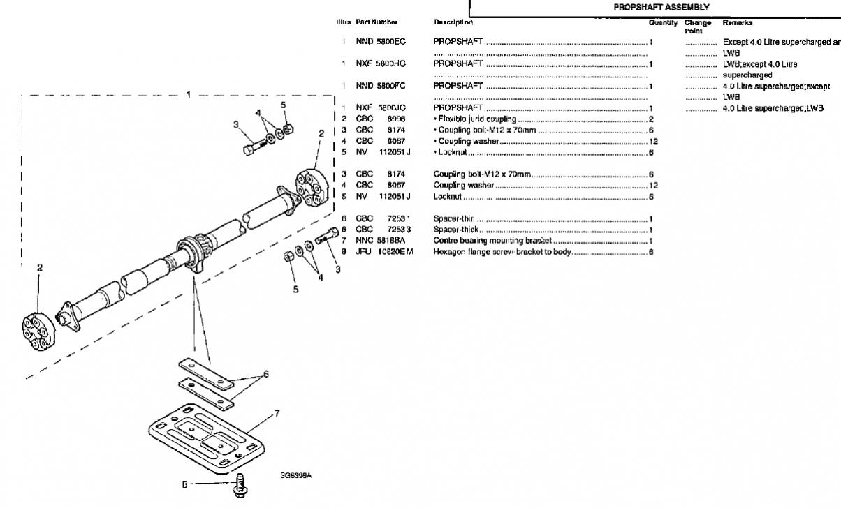

I founs 4 zerk fittings on the half-shafts but can't find any on the two piece driveshaft.....the only U-joint on my driveshaft is in the middle just above the center driveshaft bearing and I rotated it 360 and can't find any zerks. At the front of the front shaft and at the rear of the rear shaft are large fllanges but no U joints. Can you advise me on this and could mine possibly be different than yours? Thanks again for your help.

It is called a flexible jurid coupling. You should check the integrity of it. I understand that they dry out and can crack causing it to become unbalanced when spinning.

Gus, thanks for posting a break down of the propeller shaft. I did not inspect the jurid flexible couplings for cracks...will have to get the car jacked up again to do that. I have only driven it briefly since I lubed the half shaft U joints and the noise was not present. I hesitate to say the problem is fixed without more extensive road testing but I am optomistic. Will let you know and thanks again for yours and everyone elses help.
