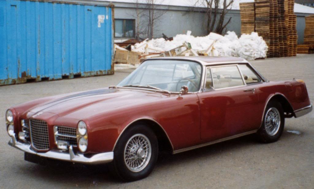

Early 90s owned this car very short time. Ou man, brilliant French bodywork and what the hell under the hood....383 Mopar - and all that from the factory. Real lump Btw. we have here a couple XJ series 2s: One with Ford 347 stroker + manual + E85 and one with new 5.7 Hemi.
I have no idea what that is but it looks damn cool. Bet it sounded the business too
