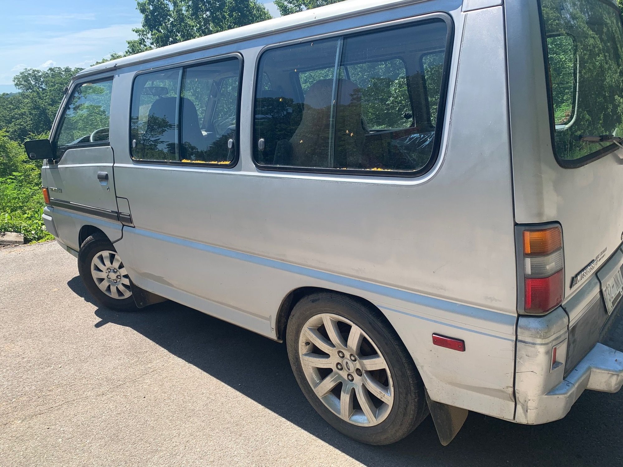

Carrying the load on the studs is problematic to be sure. I once placed some Mags on my Mitsubishi Van and the results
seemed to be encouraging....at first. I did a 360 degree turn and the right front wheel popped off! It was a low speed
maneuver and no harm was done, however I recognized the error of carrying the load on the studs. Various mechanics
have chimed in saying I could increase the center bore to accommodate things but I have never tried that. I think it looks
good with the 14" on the front and the 20" on the back. It gives it some rake without suspension mods.
