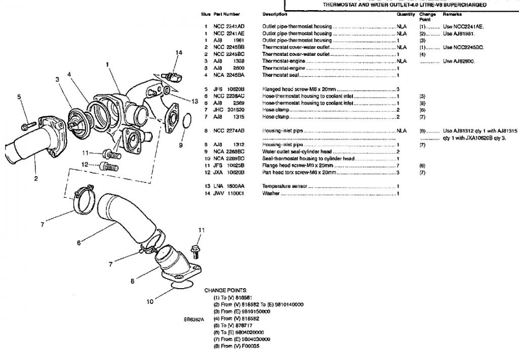

where exactly is the ECT sensor located on our cars? is that the same as the intake air sensor? i've been searching JTIS for the ECT location and have had no luck...

Here's where mine is, the brass coloured thing just beside the bulgy looking hose.

This is showing the same thing.
