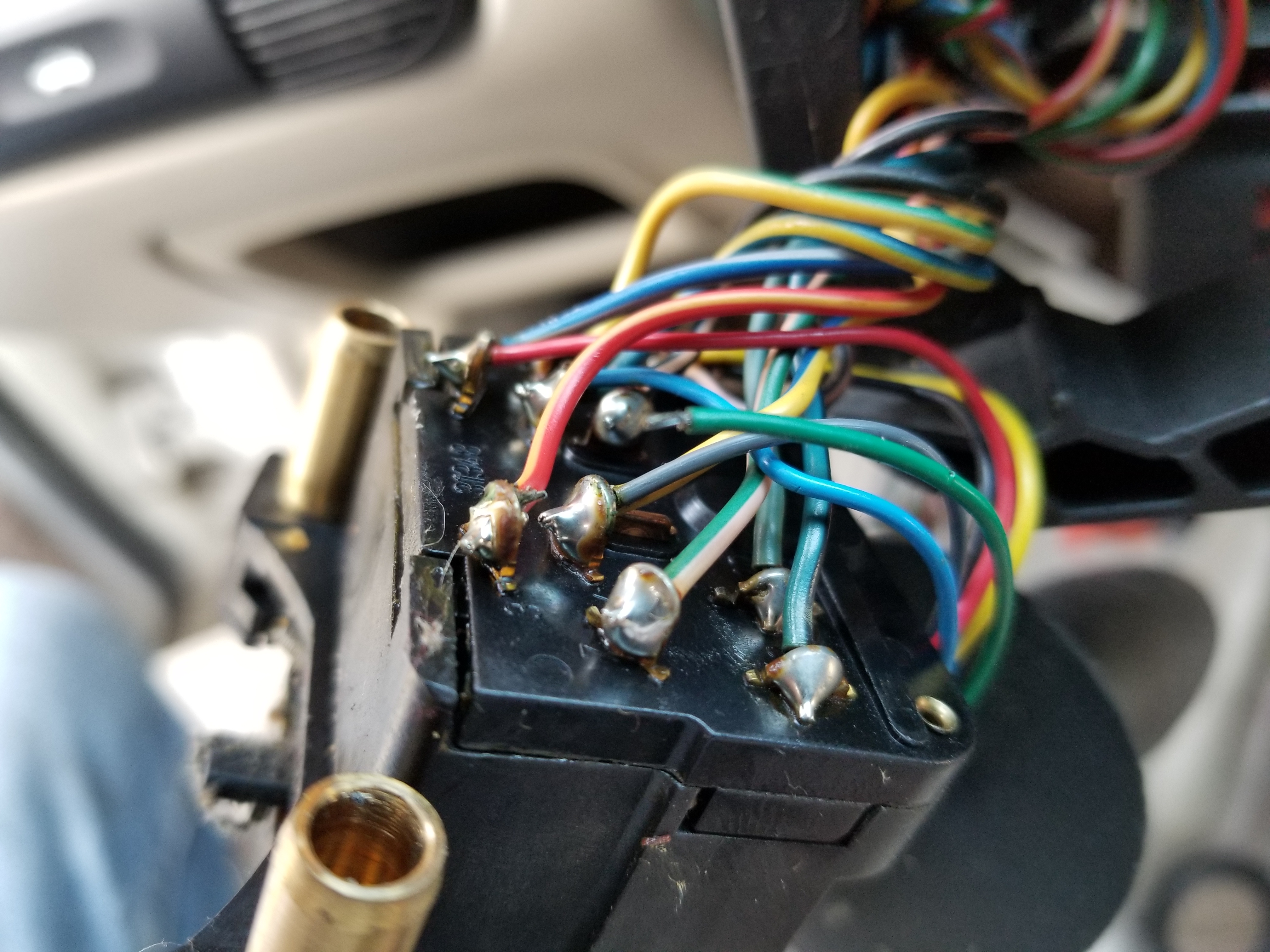

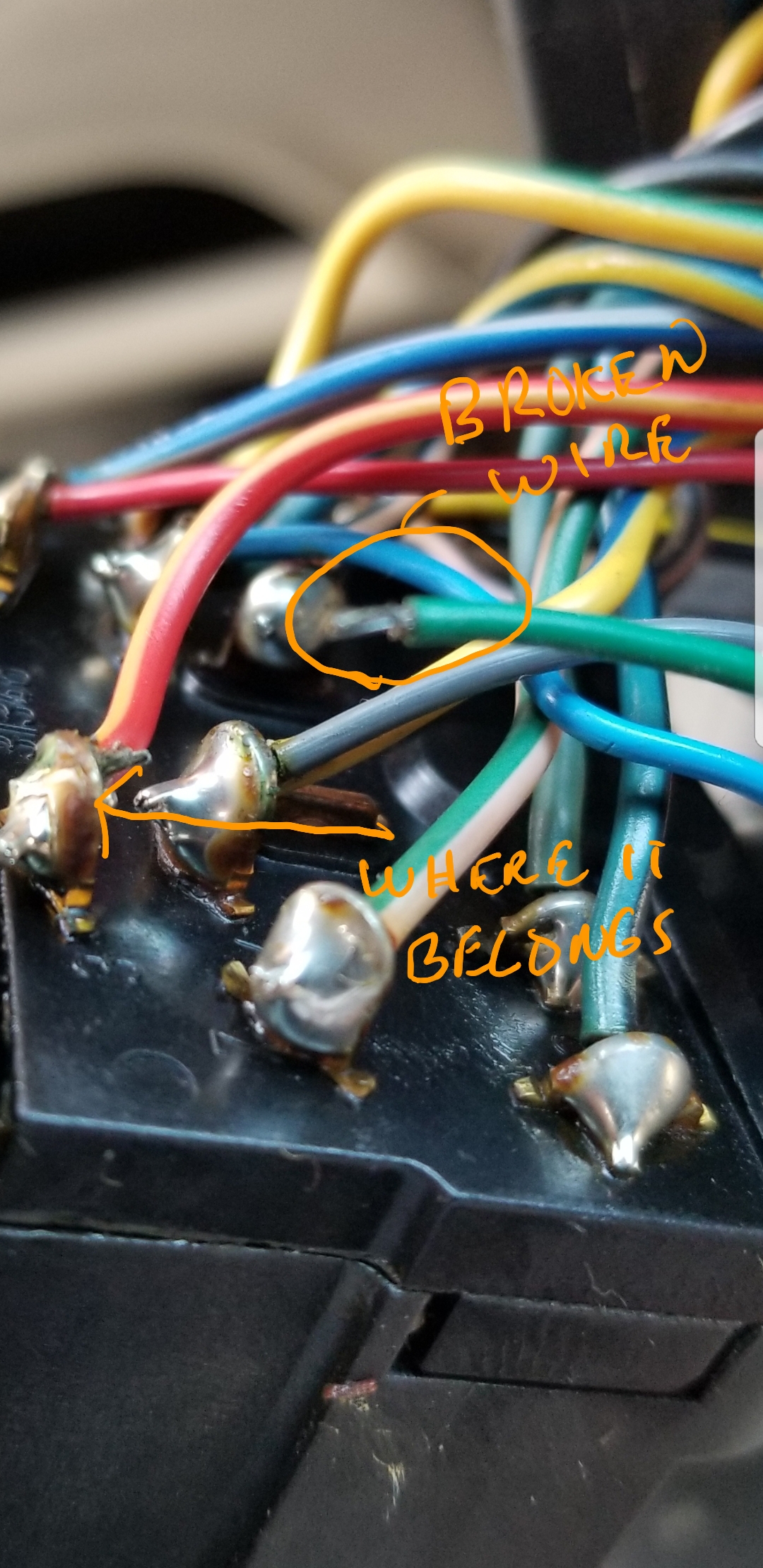

Using Dantucker's recommendation I had my son remove the steering wheel to get to the turn signal stock, I was installing the new gas range. It was the green wire that had broken loose. My son did the repair and tail and running lights now work.
Thank you to Dantucker for his recommendation, to Gus's site jagrepair.com, Lady Penelope, and Jhartz.

Picture is helpful , Thanks

That is the wire that broke on mine, glad you are back on the road.

The linked pdf for this repair is a lifesaver!
I just wanted to add, I just did this fix yesterday for my 98 VDP, and there were a couple of differences.
1, the 2 screws on the underside of the column for the cover were Phillips head, not torx.
And the top part of the cover is also held on with 3 Phillips head screws.. much easier to remove than replace, as you have to come up from the bottom to get to them (twisting/laying upside down).
otherwise, this info was priceless.
just be sure you put the steering wheel back on right side up lol
3 screws for the upper cover.
Naughty green wire.
I actually think this wire should have been at least 2-4mm longer from the factory.
Whoops.
