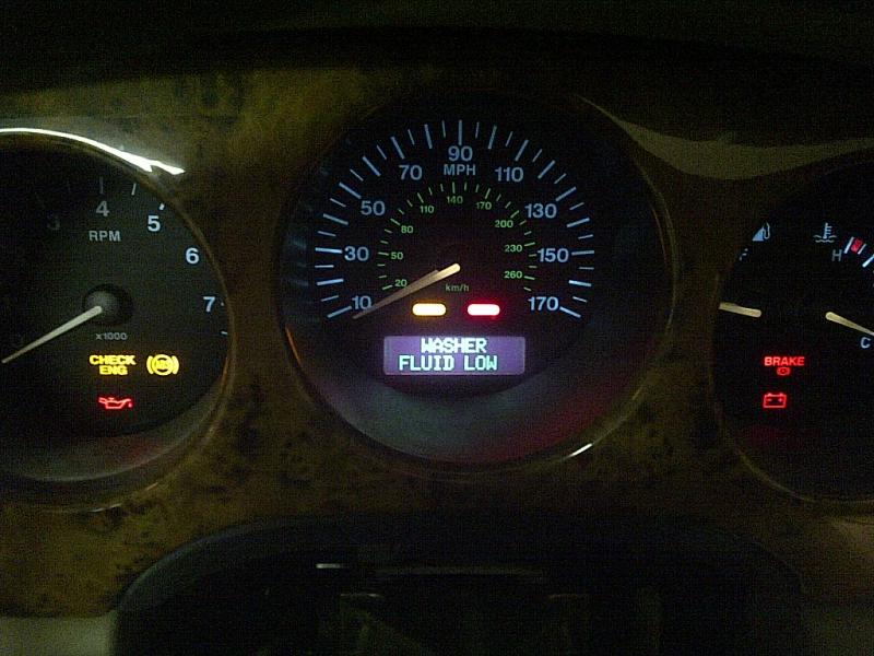

I just checked, when I turn ignition on, but don't start, there is no security light that I can see. Also no security light anywhere when I turn the car to the start position.
