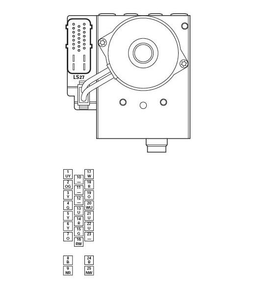

I've got the ABS / TRAC unavailable issue common with the 01. Getting ready to do the timing chain as soon as it quits snowing, and plan on doing home repair on the module while she's down. I'd pulled all the wheels, cleaned wheel speed sensors and checked resistance on front before realizing the rear harnesses disappeared into the body behind the back seat. Did some searching and made a few posts and found a real friend. A jag tech, sent me the specs and pin layout for the module connector. If you've got a multi-meter you can check the individual circuits for the wheel sensors for the proper resistance (attached file). Could save you some time and a few bucks. The basic code readers won't give you ABS feedback. I took mine into a shop that's tweaked my BMW to find out the wife left the gas cap loose - cost me 45 bucks to find out the Jag has the same fuel system vacuum sensor as most others and that 10k reader wasn't capable of pulling Jag ABS codes, at least it didn't pull any while I had it there. I'm sure the dealer has a reader for it, but you can probably get the same info they'll give you with the DIY test. I thought the attached image had the info on the pins (must be in my other laptop) do a forum search for ABS module diagram and you'll find a schematic that will show the pins to test for each wheel. Or let me know and I'll check my other laptop and send it to you.

This is not a difficult process but does take a little time and a strong desire to save a few bucks. This procedure is well documented and is a great illustration https://www.jaguarforums.com/forum/s...ad.php?t=37907 Think of the satisfaction when you do it. If you need info on the codes try this link http://www.gusglikas.com/images/Auto...xk8%201999.pdf I hope this helps!

PM me with an e-mail and I'll send you the whole Electrical Manual for the 2001, it's PDF and has every schematic on the car, layouts for every module on it, and the specs. It's something every owner should have.
RH Front - Pins 3/4
LH Front - Pins 17/18
RH Rear - Pins 7/6
LH Rear - Pins 21/22
Resistance should be in the 1000 to 1200 ohm range is what I was told. All of mine tested a little over 1100.
From what I've read, a circuit fault is typically in the harness lead directly off the sensors. The leads on the front wheels are about 18-24" and plug up in the wheel well (just follow the lead to the white connector), the rear leads are longer and disappear through a grommet in the floor pan behind the rear seat. I suppose the connectors are the same but you have to pull the seat bottom out to access them. What I saw indicated the seat could be pulled with removal of a few screws but, it seamed easier to check the circuits before I went through that. If they all test out, make sure the sensor heads are clean. You have to pull the wheels, and the sensors are mounted directly to the back side of the rotor (1 screw). Build up on the head could interfere with the signal. But if they're clean and the circuits check out, my info says it's the module. As mentioned in other posts, there is a posted fix (pics and all) that details the DIY fix for the solder pts on the module. If you go that route, I've come across posts that the car is drivable as brake lines are not removed (maintaining standard braking ability), however I've recently found a few posts that indicate removal of the module disconnects a variety of other components utilizing the wheel speed sensors, and driving without it sends the system into restricted (limp home mode). I've not been able to get any confirmation, but it might be something to keep in mind.
