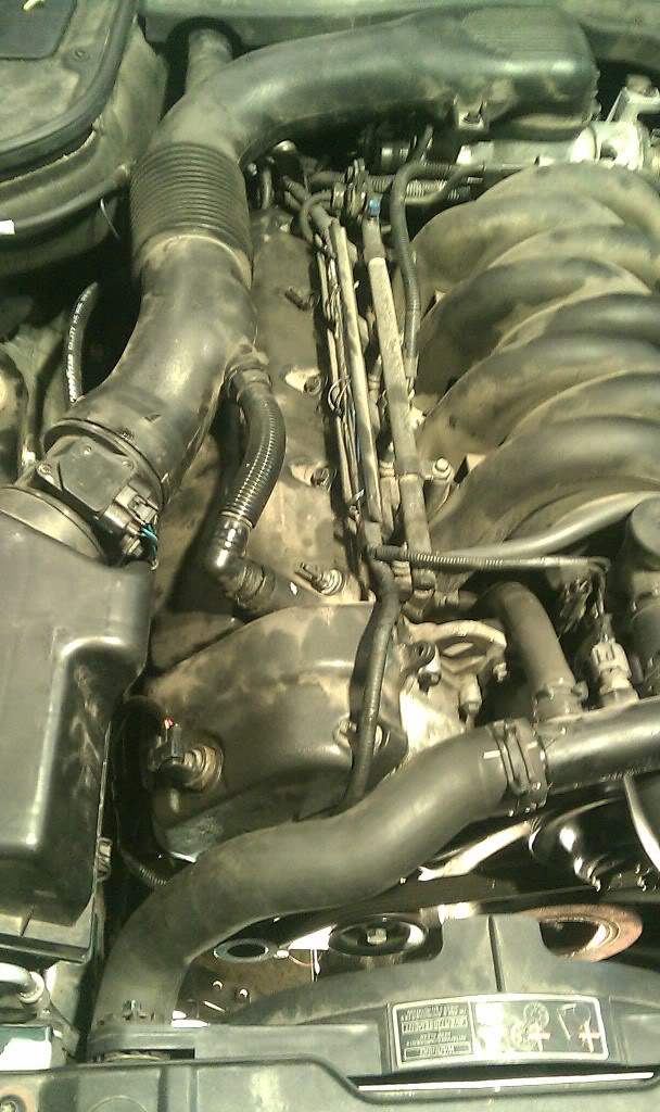

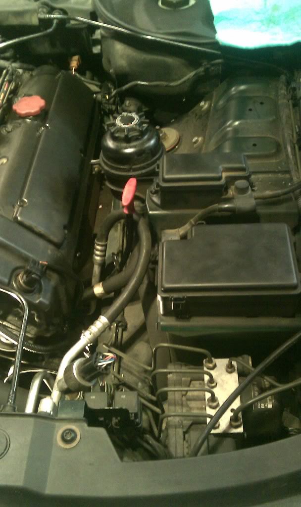

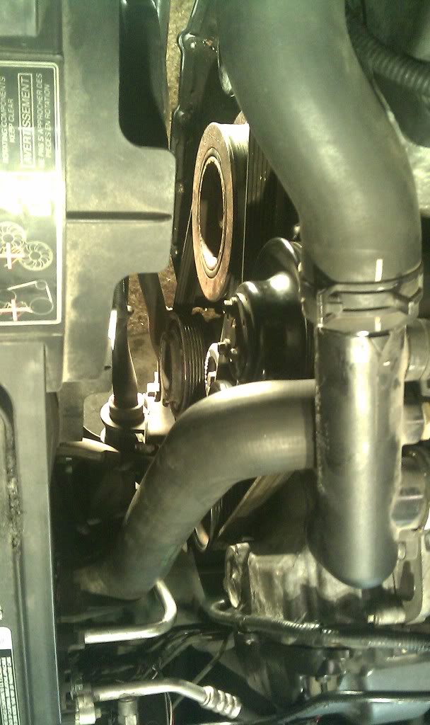

Don't listen to them, 'we' on this here forum know more. Take pictures of the engine bay of your car on post here. I'll confirm what will fit. You're right about getting an 03' with low miles, if it can be found buy it and it should drop right in...
Old Sep 7, 2012 | 08:08 AM
jagnicifant's Avatar
Joined: Aug 2012
Posts: 35
From: New Berlin Wisconsin USA
Hi All Thanks for helping me through this... Don't know how much they will help, but here are the pictures that you requested.Name:  e54a4bb5.jpg

That is definitely an AJ27 unit, this means any later 02/03 4.0 unit will go straight in, XJ8, XK8. No issues.

Any AJ27 engine is an easy fit in your car, and these 4.0 ones where build until mid 2002 or so (which would be called a 2003 model in the US). Then the production started for the 4.2 engines for the x350, so maybe there is some confusion? Anyway, best to always ask what the specific reason is why one says something that is easier to clear up afterwards.

There's a point, you can even put a 4.2 unit in without much difficulty...for ease of the job the specific unit in 4.2 would be XK8 2004 on.
Avos' point is valid, the engine suppliers are hung up on the x350 unit, but this isn't a problem, you can make these fit too.
