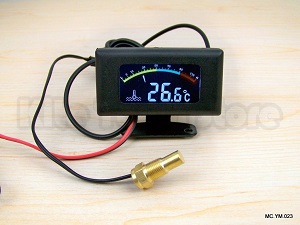

hey gentlemen new question...
i read on our forums that our engine temperature gauge is not that accurate due to the "temp filter" readings from the ECU and by the time it starts to rise its likely that you already overheated. so i was looking online for digital aftermarket gauges and found a few good ones, wiring and mounting the gauge is pretty easy. Where would the ideal/best/easiest install for the coolant temp sensor be on a 4.0 SC engine be? i have never installed one before so some information will be greatly appreciated (i will have a friend who is a mechanic help me; i have yet to speak to him about this).
want to install a gauge like those in the attachments
thank you gentlemen

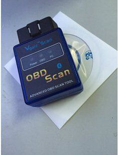

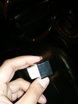

yup yup i use torque app too; this is my adapter from ebay for 10 USD! loll its a slim version with a on/off switch. its a amazing app i check codes n all i always get p1111 i noticed is that normal?
i just wanted more of a permanent approach to monitor coolant temps; because my phone battery is usually low 24/7 loll

Can someone please provide me with a coolant flow diagram for the 4.0 SC engine so i can find an ideal spot to tap into one of the coolant hoses, sensor adapters vary from 32mm to 55mm for a 1/8 NPT thread. Thank you.
